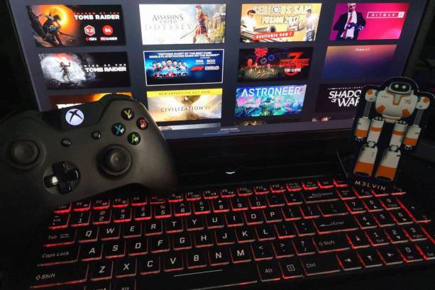

The System76 Oryx Pro laptop running Pop!_OS 19.04

I have an Oryx Pro laptop from Linux PC manufacturer System76 (the company behind Thelio and Pop OS). It packs an Nvidia GTX 2070 Max-Q graphics card, 6-Core Intel Core i7-8750H CPU and 16GB of RAM. It's a beautiful and powerful machine. It also happily runs Windows 10 because it's basically a Clevo, and System76 linked me to a couple missing drivers to get stuff like the RGB keyboard lit up. So I figured what the heck? Let's do a head-to-head, Linux versus Windows 10 benchmark run and see what shakes out.
