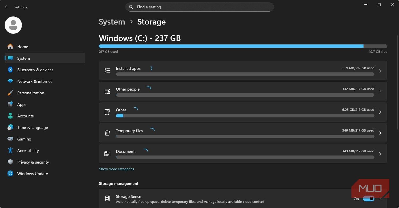

Even after startup bloat and unnecessary services have been disabled or removed, my computer doesn't always boot faster. This may be because my storage drive is not performing optimally. The SSD is often the most significant factor determining system boot time, so your next step should be to optimize it, which you can often do for free.
Your SSD may receive occasional firmware updates, just like BIOS or GPU firmware. You should make sure you’re running the latest firmware. You’ll have to visit the individual manufacturer’s support page and download their management tool. Check for firmware updates in the tool and apply any available ones.
Note
Back up any critical data before attempting a firmware update, as a failed update can render the drive unusable.
However, another trigger could be an almost-full SSD. SSDs have to manage wear-leveling and caching. But when your SSD is near full, it will slow down because it cannot find enough free blocks to write data. Ideally, you should keep at least 10–15% of the drive free. A vendor tool like Samsung Magician has an over-provisioning feature that you should enable to reserve a certain portion of the drive for maintenance, but nearly every SSD manufacturer has similar software.
However, if you do not have a vendor tool, you can manually create a small unallocated space at the end of your SSD. 10% is ideal.
