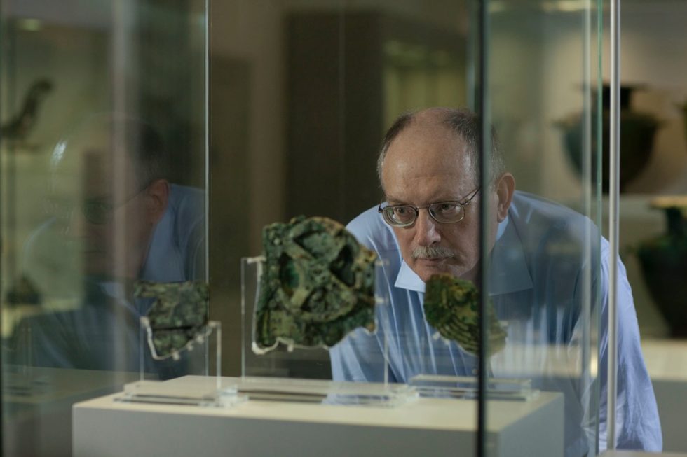

Co-author Tony Freeth examines the Antikythera fragments in the National Archaeological Museum in Athens.
