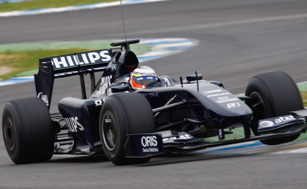

Most F1 teams developed KERS that used batteries, but the Williams F1 team created an electromechanical flywheel system. Williams ultimately did not race that system owing to Formula One technical regulations. (Interestingly, Chrysler attempted to build a natural gas/flywheel hybrid race car for Le Mans 15 years earlier, but that program never made it to a race either.)

However, Porsche eventually licensed the concept from Williams Hybrid Power and set about adapting it to endurance racing in the 911 GT3 R Hybrid. Audi, too, had a go with a flywheel in its all-conquering R18 e-tron Quattro diesel-electric prototype. The Audi prototype used a system further developed by UK automotive/aerospace supplier, GKN, which acquired Williams Hybrid Power in 2014. This flywheel hybrid racer won dozens of races, including the 24 Hours of Le Mans, outright, in 2012, 2013, and 2014.
