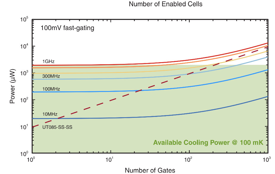

Gooseberry enables this by operating at 100mK while dissipating sufficiently low power so that it does not heat up the qubits themselves. This means that the entire setup does not exceed the cooling capacity of commercially available quantum computing refrigerators. The team also used Gooseberry to create what it is calling the novel general-purpose cryo-compute core.

Putting Gooseberry to the test, the researchers connected with it a GaAs-based quantum dot (QD) device. Temperature of the components of the chip were measured as the control chip was powered up. As expected, the temperatures remained below 100mK, within the necessary range of frequencies and clock speeds. These results were extrapolated, showing the total system power needed for Gooseberry as a function of frequency and the number of output gates.
