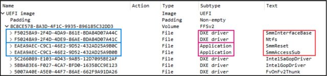

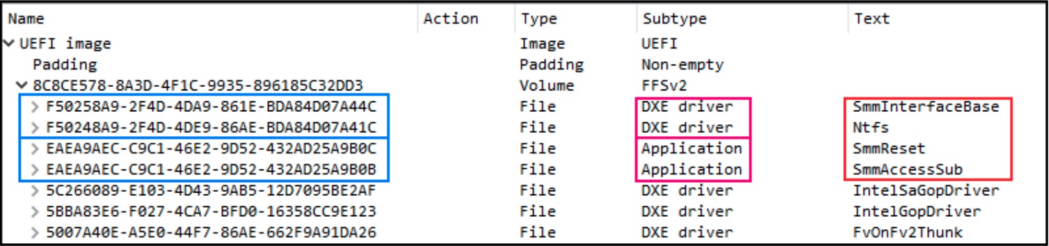

Reengineering showed that the original UEFI image, from firmware maker AMI, had been patched to add malware that was based on a malicious UEFI bootkit made by, and later stolen from, Hacking Team, the Italy-based exploit and implant seller that was spectacularly hacked in 2015.
Three of the four added modules were lifted directly from the stolen source code of the UEFI bootkit, which Hacking Team sold to governments—some from countries with poor human rights records such as Egypt, Saudi Arabia, and Russia. A fourth module—which served as the main bootkit component—was based on the one from Hacking Team but had been almost completely rewritten from scratch.
Rogue components found within the compromised UEFI firmware.
Enlarge / Rogue components found within the compromised UEFI firmware.

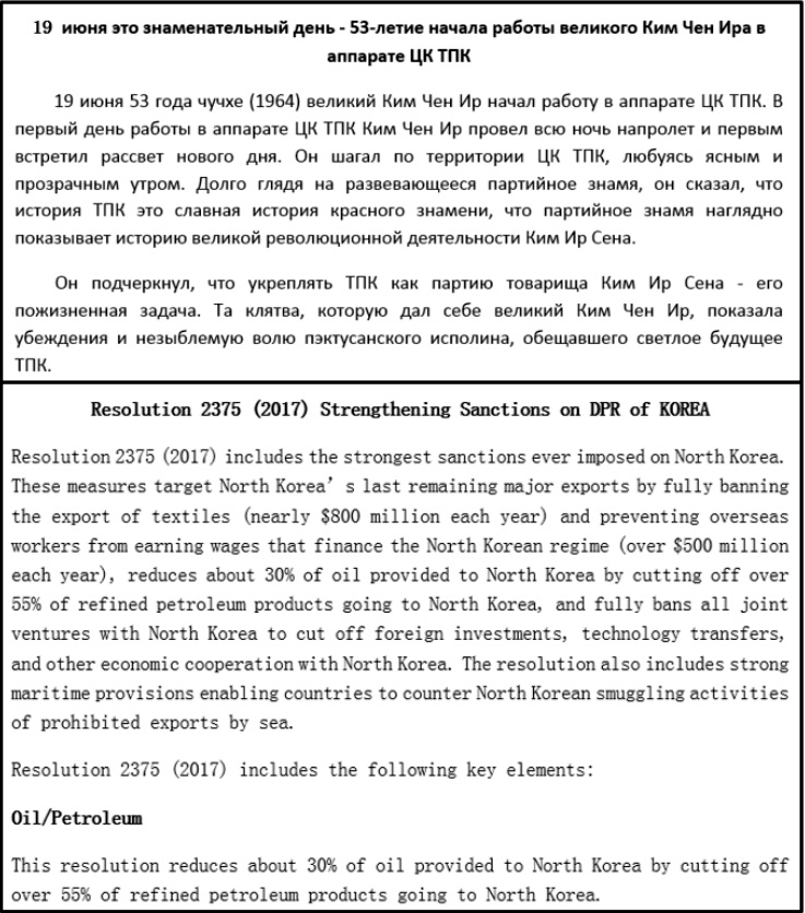

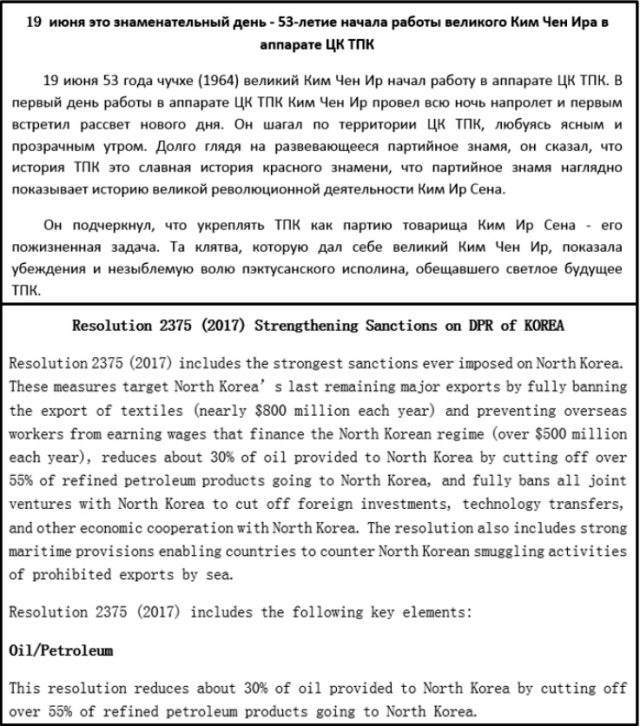

Kaspersky Lab researchers also uncovered evidence that the bootkit was only one way it got installed. Files included in one of the MosaicRegressor archives showed two documents that were likely used in spear phishing attacks. Two examples of malicious archives delivering MosaicRegressor showed documents that were likely used in spear phishing attacks. Both lure documents—one written in Russian and the other in English—discussed matters involving North Korea.
Examples of lure documents bundled to malicious SFX archives sent to MosaicRegressor victims, discussing DPRK related topics
Enlarge / Examples of lure documents bundled to malicious SFX archives sent to MosaicRegressor victims, discussing DPRK related topics
Kaspersky Lab
The researchers found other data that’s potentially useful in piecing together who was behind the attacks. Strings used for generating log messages within the malware included characters that were either from the Chinese or Korean languages. One of the languages the attacker’s computer had installed appeared to be Chinese. Kaspersky takes the evidence to mean that the attackers are Chinese-speaking.
According to researchers at security firm ProtectWise, one of the command servers MosaicRegressor connected to had been used in the past by a malicious backdoor from “Winnti Umbrella,” a prolific set of threat actor groups that the researchers said “operate under the Chinese state intelligence apparatus.”
Taken together, the evidence suggests the attacks were carried out by a Chinese-speaking actor who may have used the Winnti backdoor in the past, Kaspersky Lab researchers said. But they caution: “Since this is the only link between our findings and any of the groups using the Winnti backdoor, we estimate with low confidence that it is indeed responsible for the attacks.”

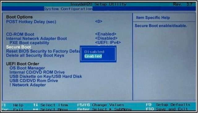

Password-protecting the UEFI bootup process is also an effective measure to prevent firmware tampering. Using full-disk encryption can also be a help because, should UEFI firmware be hacked, it won’t be able to write to the disk.
But by and large, hardware and firmware providers still aren’t spending enough resources to build defenses needed for products to effectively withstand attacks. Secure boot, because it only protects the boot process during run time, isn’t the answer. And security companies are only now starting to design scanning for mainstream users.

Use Windows 10, turn on Bitlocker for C drive for full drive encryption, password protect UEFI, enable secure boot in UEFI which uses Windows 10 security feature.
