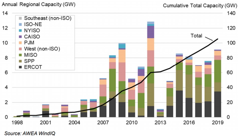

Earlier this year in the US, energy generation from wind, solar, and hydroelectric dams combined to top coal generation for over two months straight. This was the product of spring peaks in renewable generation and reduced electrical demand during lockdowns, but those events were layered on top of coal’s continuing decline and the long-term growth of renewables. A new report from the Lawrence Berkeley National Laboratory looks back at 2019—what is now known as the Before Times—to tally up year-end totals for the wind industry.
The topline number is that a little over nine gigawatts of wind capacity was added last year—slightly more than in each of the four previous years. Wind accounts for about one-third of all new generation added in 2019, and it ticked up to seven percent of all electricity generated in the US.

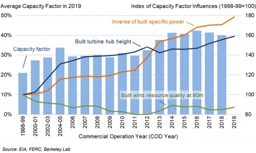

The trend toward bigger wind turbines continued, with the average capacity of a turbine built last year reaching 2.55 megawatts. The height of the tower on which the turbine sits has risen over time—now averaging 90 meters—but the bigger factor is longer blades. Average rotor diameter was 120 meters, up from closer to 80 meters a decade ago.
Over 1,800 older turbines were retrofitted last year, mostly with longer blades. That slightly increases their maximum capacity, but more importantly it leads to more consistent generation. These changes have boosted “capacity factors”—the average fraction of a turbine’s maximum capacity that it is generating as the winds vary over the days and seasons. The report notes that the average capacity factor of turbines built 2014-2018 was 41 percent, beating out turbines built 2004-2012 that come in at 31 percent. Newer turbines are also aging more gracefully, maintaining their output better than wind farms built before 2008.
