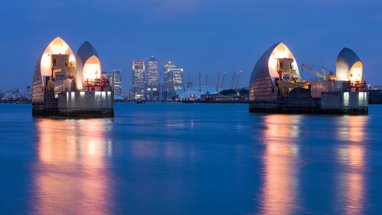

The Thames Barrier helps to protect London from flooding as caused by the ever increasing tidal range in the Thames Estuary (Credit: Alamy)

tides back. And in the Thames estuary that runs through London, engineers have narrowed and deepened the river over centuries – its tidal range has increased from around 2m
(6.6ft) in the time of the Romans to around 8m (26.2ft) in the Victorian age.
