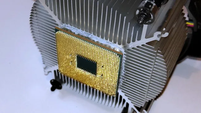

If you've built any AMD Ryzen systems of late, or upgraded their cooling, you may have come across a particular problem with the AM4 socket. The CPU can be pulled out of the socket when you try removing the cooler, even though the retaining arm is locked down. The thermal paste effectively glues the chip to the cooler, and the socket itself doesn't grip the CPU hard enough to win that particular tug of war.

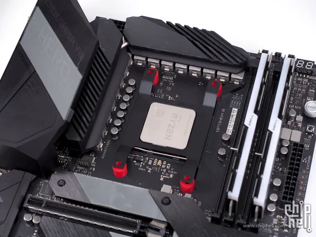

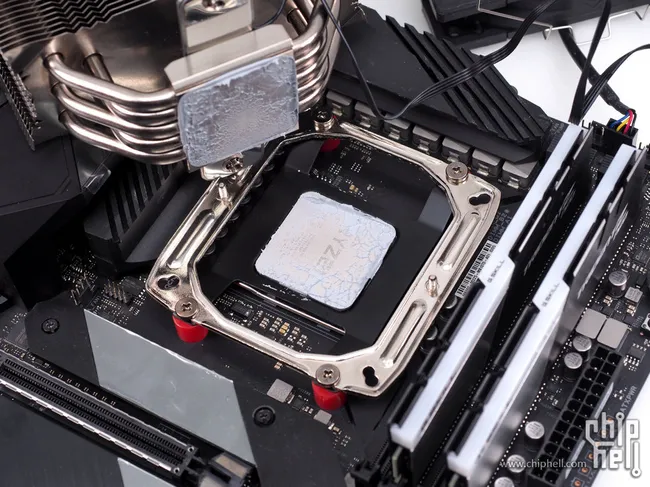

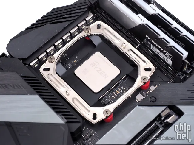

A new solution to this problem has appeared on a Chiphell forum courtesy of kthlon, who was looking at the ProArtist Desserts2 CPU cooler that includes a retention bracket in the package. It doesn't interfere with the top of the heatspreader, so doesn't have a negative effect on cooling, but it does clamp the CPU down so that when you remove the chiller, your Ryzen processor doesn't get yanked out with it.
This isn't a universal solution at this point, because there are standoffs involved, that need to be the right height for the cooler used, although it shouldn't be too hard to get this working with more coolers. This retention bracket is only available in China at the moment, although given the interest in it, and the simple design, I'd hope it gets picked up by other cooler manufacturers quickly.
