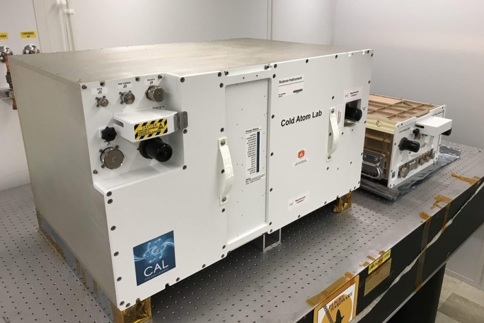

Physicists at Caltech and the Jet Propulsion Laboratory have created a rare quantum state of matter known as a Bose-Einstein condensate (BEC) in space for the first time, according to a recent paper published in the journal Nature. The physicists did so by placing a compact experimental setup the size of a mini-fridge on board the International Space Station (ISS). It's called the Cold Atom Laboratory (CAL), aka "the coolest spot in the universe."

While the laboratory equipment required to make a BEC on Earth can easily fill a room, JPL's miniaturized CAL is just 14 cubic feet and only needs about 510 watts to operate, making it ideal for ISS microgravity experiments. CAL was installed on board in May 2018. Right now the setup uses rubidium atoms to make the BECs, but there are plans to incorporate potassium atoms into the mix to explore the physics of mixed BECs.
