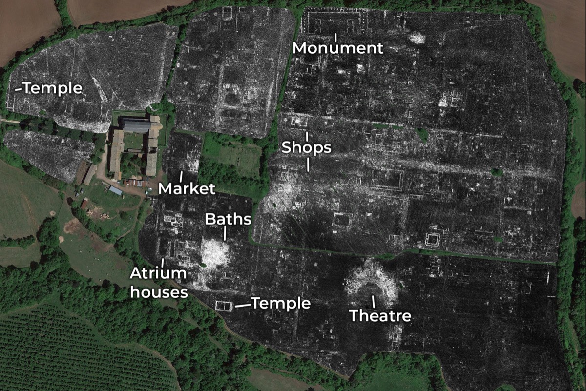

The authors attached their GPR system to the back of an ATV in order to more efficiently survey the 30.5 hectares (about 75 acres) within the ancient city's walls, taking a reading
every 12.5 centimeters. In 2017, using their method, the team found the remains of a large Roman temple, several feet below the town, that would have been roughly the same
size as St. Paul's Cathedral.
This latest analysis revealed a large rectangular structure connected to a network of water pipes, leading to the city's aqueduct. The authors surmise that it is the remains of an
open-air pool (natatio), part of a large public bathing complex. They were also surprised to see two large structures facing each other within a covered passageway (porticus
duplex) that they believe was once part of a large public monument near the city's north gate. It seems to be part of a "sacred topography" of temples around the town's
periphery, previously revealed by magnetometer surveys.

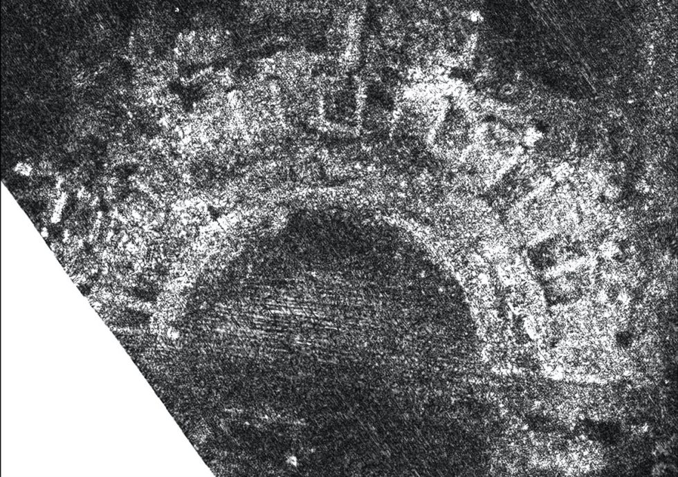

noting that the shop units of Falerii Novi, for example, show up in the magnetic data but not in the GPR survey. And while the city's theater shows up in the magnetic data, the
GPR survey provided a much clearer view, including at different depths, yielding insight into its structural form, as well as evidence of the removal of walls via stone-robbing.
