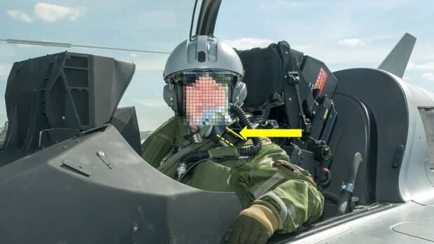

The drama is outlined in a newly released report by French aviation investigators which at times reads like a dark comedy script, as it describes how the unidentified 64-year-old panicked during his first flight in the Rafale-B.
Then he shot out at high speed, losing his helmet that had not been fastened around his chin properly, before landing in a field close to the German border.
His anti-g force suit, worn by aviators who are subject to high acceleration forces and designed to prevent a blackout, had also become loose.
It was only through good fortune that the pilot was not ejected by his passenger's actions, so ensuring a certain crash.

The pensioner, meanwhile, had expected a gentle ascent, but the plane "climbed at 47 degrees", compared to around 10 to 15 degrees for a standard passenger plane.
This was when the Frenchman reached out to hang on to anything to steady himself and pulled the ejector handle.
There was a loud bang, with the force of the ejection tearing his unsecured mask and oxygen mask away.
The Rafele-B's command ejection system is meant to fire both seats at once – meaning the pilot feared his seat would fly out at any moment.
Instead he managed to land, while the pensioner's parachute worked, and he arrived in a field, shocked and with minor injuries.
