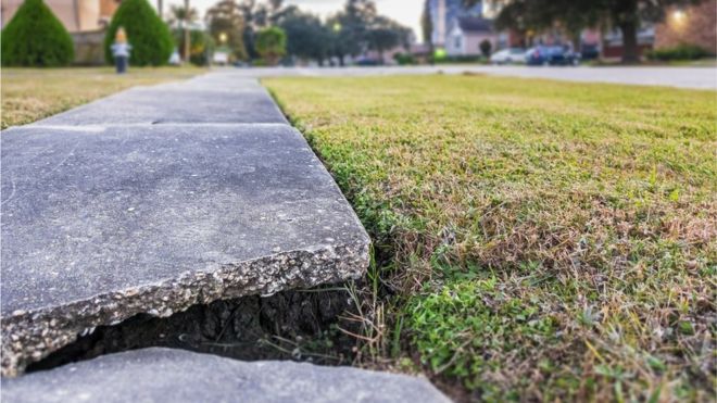

Cracks are everywhere from pavements to bridges
Whatever their size, cracks can be bad news. They make planes fall out the sky and bridges fall down. On a more mundane level they trip you up on a badly-maintained pavement.
