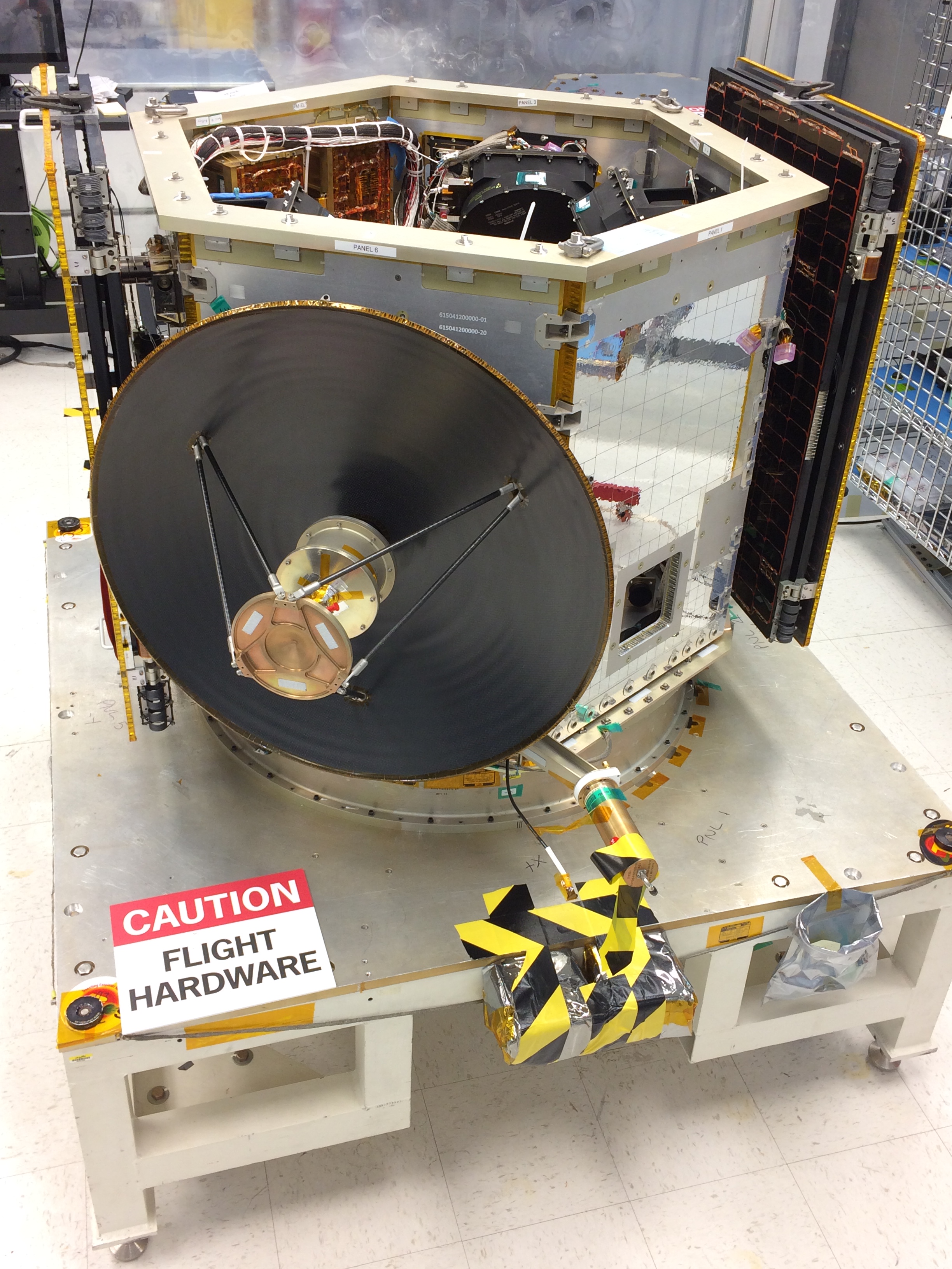

The TESS observatory prior to launch.
Enlarge / The TESS observatory prior to launch.
When an exoplanet transits in front of its star, most of the light that reaches Earth comes directly to us from the star. But a small percentage passes through the atmosphere of the exoplanet, allowing it to interact with the gases there. The molecules that make up the atmosphere can absorb light of specific wavelengths—essentially causing them to drop out of the light that makes its way to Earth. Thus, the spectrum of the light that we can see using a telescope can contain the signatures of various gases in the exoplanet's atmosphere.
There are some important caveats to this method, though. Since the fraction of light that passes through the exoplanet atmosphere is small compared to that which comes directly to us from the star, we have to image multiple transits for the signal to stand out. And the host star has to have a steady output at the wavelengths we're examining in order to keep its own variability from swamping the exoplanetary signal. Finally, gases in the exoplanet's atmosphere are constantly in motion, which can make their signals challenging to interpret. (Clouds can also complicate matters.) Still, the approach has been used successfully on a number of exoplanets now.
