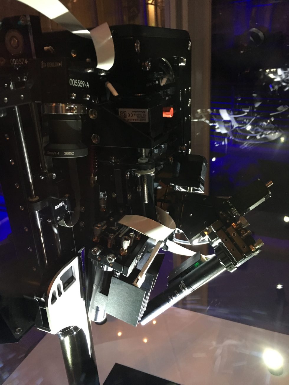

The robot
The Neuralink introduction included a video of the brain during surgery, revealing how the wrinkly organ constantly shifts with breathing and blood flow. This makes implanting electrodes a challenge, especially since much of the brain is laced with blood vessels that the electrodes could easily puncture. Plus, due to their incredibly small size, the electrodes themselves are susceptible to damage.
The robot keeps a surgeon in charge, but it turns the process of electrode implantation into something closer to a video game. Using a microscope integrated into the robot, a surgeon is given a static view of the underlying brain, thanks to software that compensates for the pulsing and shifting. With the static view, implanting the electrodes becomes something like a point-and-click activity: the surgeon selects a location, and the robot inserts the electrode there while compensating for any ensuing movement of the underlying tissue. Although video showed its insertion method as looking like a violent stab, the hardware protects the electrodes from damage at this point.
This method certainly has the potential to make electrode implantation safer, in part by minimizing the risk of blood-vessel damage. But let me be clear: while the electrodes are small enough that they're not dramatically larger than the neurons they interact with, there's still the potential for damage to those neurons or their support cells during the electrode insertion, as well as some disruption of the connections among neurons. That potential may be lowered by the robot, but it's not going away.
One other issue that the robot doesn't obviously solve is that several of the images displayed during the Neuralink introduction showed the chips being located somewhere other than where the electrodes were targeted. There's certainly enough play in the wiring of the electrodes to allow a bit of distance between the two, but it's hard to understand how this can be managed with a single, small surgical incision.

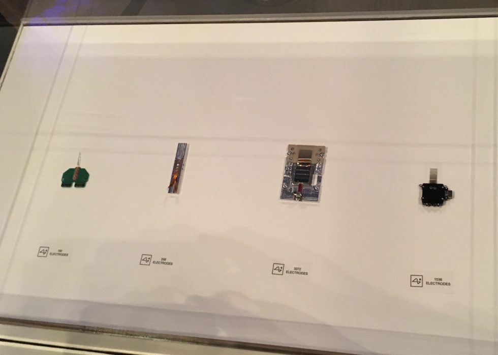

The electrodes
In existing systems, the electrodes are their own distinct hardware component, but Neuralink is seeking to change this. The company hopes to do so by producing the metal portion of the electrodes as it's building layers of metal into the chips used for processing the electrode data. This provides some real advantages, as the process technology used there is already operating at the sort of fine scales that make structure of the electrodes easy.
This setup would also do away with any bulky connector hardware currently needed to link electrodes with the rest of the system—they're already part of it. Presumably, Neuralink will manufacture chips with electrodes of different lengths to allow for flexibility in the implantation process.

The obvious Neuralink advance is the size of the implant. As you could see in that video, existing electrodes are hooked up to a substantial box that protrudes from the skull, needed in part because the electrodes need adaptors before they can talk to any other hardware. Neuralink wants to get rid of all of that. It wants the surgery to be elective and outpatient, and it wants the recipients of its hardware to be able to go home with it and go about their lives as normal. In service of that goal, the company has gotten rid of most of this complexity, reducing the implant to electrodes directly integrated into a small chip on a circuit board with a USB-C connection.
The chip, and the fact that it is integrated with its electrodes, is the key to this advance. While there has been some hardware demonstrated in academic labs that allows mice and rats to move freely with implanted electrodes, that hardware's still quite a bit bulkier, and the animals are undoubtedly aware of its presence. If Neuralink gets its wireless connection working, the results would be somewhat better than the cutting edge present in research labs, and made in volume.
Research animals have been getting ever-smaller implants, although the smaller implants haven't shifted to humans yet.
This is where the research community was heading, but Neuralink should get the community there with the consistency of hardware that's produced at scale. And the Neuralink scientists made it clear they want to cooperate with researchers when the hardware's ready. (When talking about using this in animal research, Musk joked, "We even care about rats, even though they carry the Black Death.")
