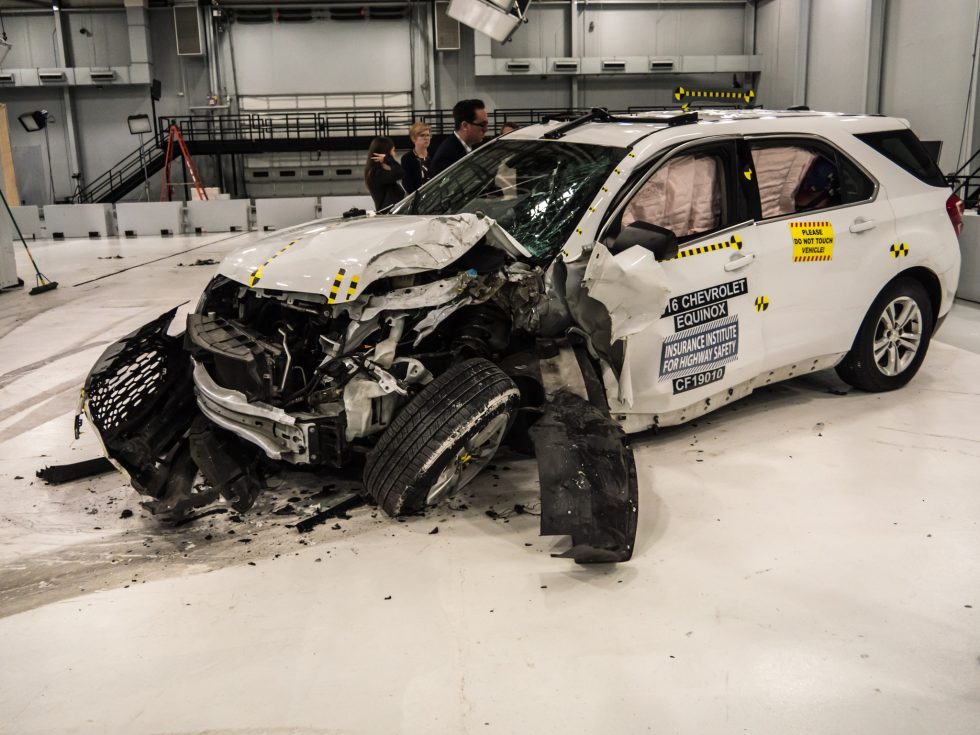

IIHS continues to develop new crash-test procedures. On the day that I visited, we witnessed one of these research tests, focused on rear-seat occupant safety. As with IIHS' previous tests, this one arose from a perceived need. In this case, the institute wanted OEMs to fit the rear seats with the same seatbelt devices (pretensioners and force limiters) as those in the front seats.
This test was also a 25% frontal offset at 40mph, but it carried three test dummies—an adult male up front and two child dummies (one male, one female) in the back. As you'll note in the photos, the Chevrolet Equinox didn't behave perfectly: one of the children's heads ended up between the window and the side curtain airbag.
