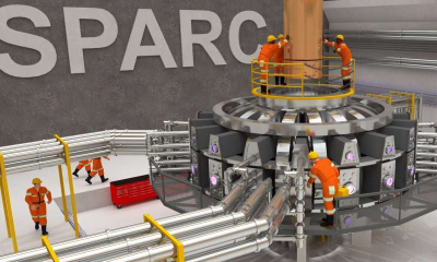

A rendition of the SPARC high-field tokamak experiment, which would produce the first fusion plasma to have a net energy gain. Credit: Ken Filar

Once the magnet development is successful, the next step will be to construct and operate the SPARC fusion experiment. SPARC will be a tokamak fusion device, a type of magnetic confinement configuration similar to many machines already in operation (Figure 1).
