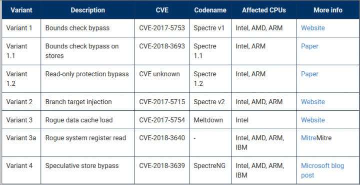

If you've lost track of all the recent Meltdown and Spectre-related CPU bugs, we've put together the following table to help you keep track of all the variations.
