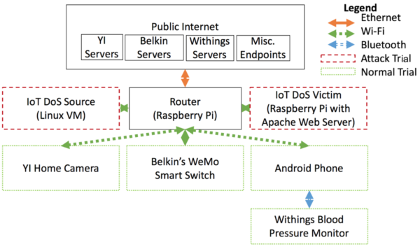

Finding #4: Smart Home Device Traffic is Predictable, Facilitating Anomaly Detection
The Mirai botnet used hacked IoT devices to conduct distributed denial of service (DDoS) attacks on critical Internet infrastructure. Most owners of these devices had no idea that their security cameras or DVRs were participating in the attack.
Figure 2: Test network setup for experiments detecting misbehaving devices.
An in-network device or service should be able to automatically detect misbehaving devices and notify users that their devices have been compromised.To evaluate this concept, we have set up a test network to simulate a DDoS attack from a compromised IoT device in a consumer home, as shown in the figure.
We are experimenting with machine learning-based DDoS detection using features using IoT-specific network behaviors (e.g., limited number of endpoints and regular time intervals between packets). Preliminary results indicate that home gateway routers or other network middleboxes could automatically detect local IoT device sources of DDoS attacks with high accuracy using low-cost machine learning algorithms.
