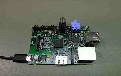

What is Raspberry Pi?
Raspberry%2Bpi_kali%2Blinux_android_pica
The Raspberry Pi is a low cost, credit-card sized computer that plugs into a computer monitor or TV, and uses a standard keyboard and mouse. It is a capable little device that enables people of all ages to explore computing, and to learn how to program in languages like Scratch and Python. It’s capable of doing everything you’d expect a desktop computer to do, from browsing the internet and playing high-definition video, to making spreadsheets, word-processing, and playing games.
What’s more, the Raspberry Pi has the ability to interact with the outside world, and has been used in a wide array of digital maker projects, from music machines and parent detectors to weather stations and tweeting birdhouses with infra-red cameras. We want to see the Raspberry Pi being used by kids all over the world to learn to program and understand how computers work.

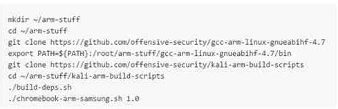

A sample workflow would look similar to (armhf):
And slightly modified the workflow to the below:-

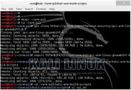

mkdir ~/arm-pi2
cd ~/arm-pi2
git clone https://github.com/offensive-security/gcc-arm-linux-gnueabihf-4.7
export PATH=${PATH}:/root/arm-pi2/gcc-arm-linux-gnueabihf-4.7/bin
git clone https://github.com/offensive-security/kali-arm-build-scripts
cd ~/arm-pi2/kali-arm-build-scripts
Then download the Raspberry Pi 2 kernel configuration, to the current folder (kali-arm-build-scripts) using the following command:-
wget http://pastebin.com/download.php?i=Rv3zpsiv -O pi2_kernel.config

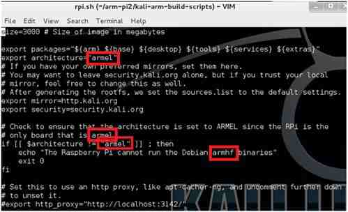

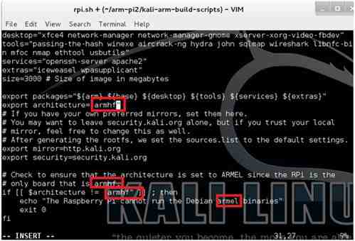

Then modify the rpi.sh script as below:-
Replacing "armel" above with "armhf" as below, as the Raspberry PI uses the armhf architecture.

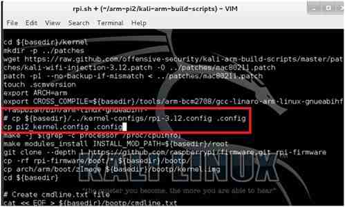

Then continue to modify the rpi.sh file to load the new kernel configuration as below, and then save the modified rpi.sh to disk. (with vi :wq).

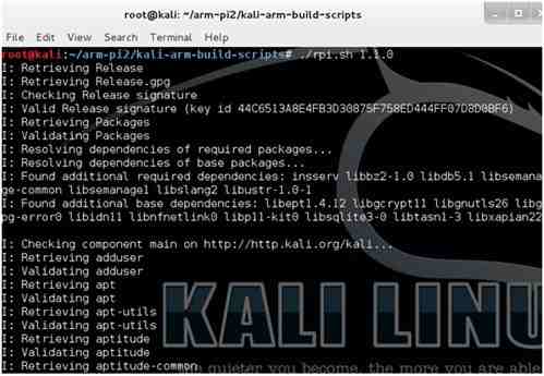

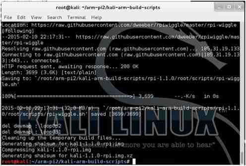

Then ran./build-deps.sh
And built the image using version 1.1.0 of Kali Linux:
./rpi.sh 1.1.0
The image file kali-1.1.0-rpi.img,xz was produced:-

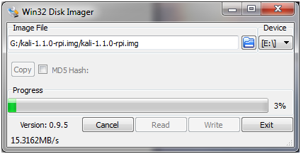

For the next steps I'm used a Windows laptop with a built in SD card reader, to write the created img to a high capacity SDHC card.
Extract the xz file to an img file using the Windows 7-zip program, and then use "Win32 Disk Imager" to write the img to the SDHC card.

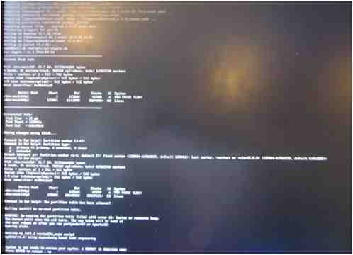

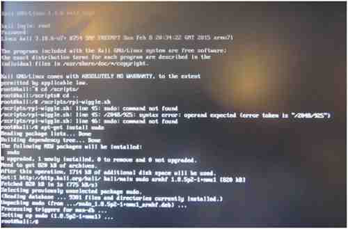

As i wanted to use the full flash SD card size, as the full kali Linux build which i want to install is too big for the default image, So i am then expanded the image to the full size of the flash SD card, using the following commands :
/scripts/rpi-wiggle.sh
However the sudo and parted programs were missing, so we had to use apt-get to install them:-
apt-get install sudo
apt-get install parted
Then the rpi-wiggle.sh program was able to run:-
After this the Raspberry Pi will be reboot, Now ready for the full Kali build to be installed.

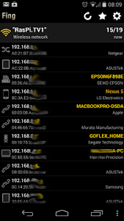

Fing
  • You’ve just switched on your Raspberry Pi but you forgot to connect the HDMI lead, so you have no display. You don’t want to pull the plug, but you can’t ssh into it without the ip address. How to find it? Or…
  • You got your headless Raspberry Pi up and running, but you forgot what ip address it’s on. Or…
  • You rebooted your internet router and it’s changed the ip address of the Pi. What do you do?
You install Fing on your phone and use it to scan your whole network and tell you the ip and mac addresses of every connected device.
Very useful indeed. There’s no looking back once you’ve got Fing installed. It’s a superb app. You can assign names to each device and choose an appropriate icon to make identification easier. They recently added a Raspberry Pi icon too…
