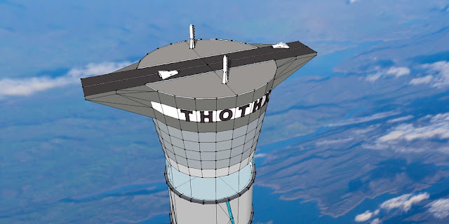

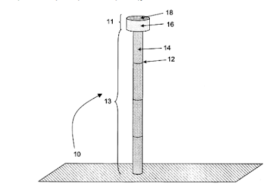

Canadian space company, Thoth Technology Inc., has been granted the United States patent for a inflated tower. The freestanding space tower is pneumatically pressurized and actively-guided over its base. Reaching 20 km above the planet, it would stand more than 20 times the height of current tall structures and be used for wind-energy generation, communications and tourism.
The technology offers an exciting new way to access space using completely reusable hardware and saving more than 30% of the fuel of a conventional rocket.

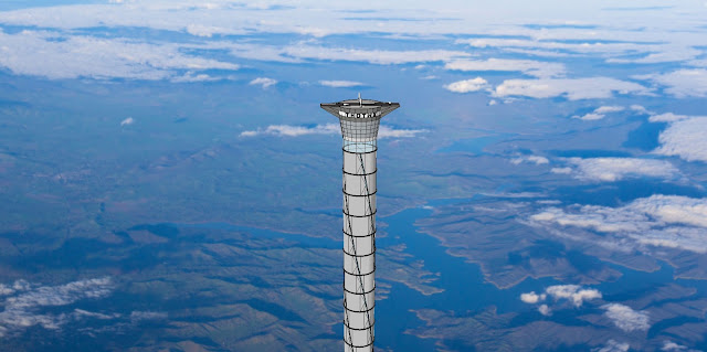

Inflatable pneumatic modules already used in some spacecraft could be assembled into a 15-kilometre-high tower. Brendan Quine, Raj Seth and George Zhu at York University in Toronto, Canada, wrote in Acta Astronautica (DOI: 10.1016/j.actaastro.2009.02.018) "A free-standing space elevator structure: A practical alternative to the space tether". If built from a suitable mountain top it could reach an altitude of around 20 kilometres, where it could be used for atmospheric research, tourism, telecoms or launching spacecraft. They calculate the tower could be extended up to low Earth orbit at 200 kilometres.
The team envisages assembling the structure from a series of modules constructed from Kevlar-polyethylene composite tubes made rigid by inflating them with a lightweight gas such as helium. To test the idea, they built a 7-metre scale model made up of six modules. Each module was built out of three laminated polyethylene tubes 8 centimeters in diameter, mounted around circular spacers and inflated with air.
To stay upright and withstand winds, full-scale structures would require gyroscopes and active stabilisation systems in each module. The team modelled a 15-kilometre tower made up of 100 modules, each one 150 metres tall and 230 metres in diameter, built from inflatable tubes 2 metres across. Quine estimates it would weigh about 800,000 tonnes when pressurised - around twice the weight of the world's largest supertanker.
Space tethers have been investigated widely as a means to provide easy access to space. However, the design and construction of such a device presents significant unsolved technological challenges. We propose an alternative approach to the construction of a space elevator that utilizes a free-standing core structure to provide access to near space regions and to reduce the cost of space launch. The structure is comprised of pneumatically inflated sections that are actively controlled and stabilized to balance external disturbances and support the structure. Such an approach avoids problems associated with a space tether including material strength constraints, the need for in-space construction, the fabrication of a cable at least 50,000 km in length, and the ageing and meteorite-damage effects associated with a thin tether or cable in Low Earth Orbit. An example structure constructed at 5 km altitude and extending to 20 km above sea level is described. The stability and control of the structure, methods for construction and its utility for space launch and other applications are discussed.
