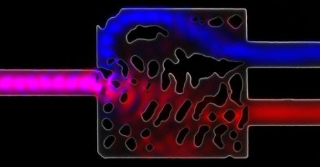

But while engineers aregetting very close to creatingcomputer chips that can process light, theyve struggled to find an efficient way to transmit that light across the thousands of different connections, known as interconnects, between them. In theory, light can be beamed between chips via silicon structures that bend it to the desired location, but these are incrediblydifficult to build, andhaving to create a new silicon structure to replace every single wire inside just one computer could be next to impossible.
Now the Stanford University team has come up with a better solution, by developing an inverse design algorithmthat tells them exactly how to buildthe silicon structures they need to perform a desired task. Theyve already used the algorithm to design a working optical circuit, and have made several copies in their lab.
Reporting in Nature Photonics, the team has now demonstrated that these devices worked perfectly, despite tiny imperfections in the structures. "Our manufacturing processes are not nearly as precise as those at commercial fabrication plants," said Alexander Piggott, who worked on the algorithm. "The fact that we could build devices this robust on our equipment tells us that this technology will be easy to mass-produce at state-of-the-art facilities."
So how exactly do you build a silicon interconnector? Basicallyit involves layering slices of silicon that are so thin that more than 20 of them could sit side-by-side in the diameter of a human hair.Light easily passes through silicon, but isalso bends as it does so. By designing very precise segments of silicon and pairing them together -according to the instructions of the algorithm - the team areable to create switches orconduits that control the flow of photons, just like wires currently do with electrons.
"Our structures look like Swiss cheese but they work better than anything we've seen before," said Vuckovic.
By creating an algorithmthat automates the development ofthese complex Swiss cheese silicon structures, the team has essentially "set the stage for the next generation of even faster and far more energy-efficient computers that use light rather than electricityfor internaldata transport," as the press release explains .
