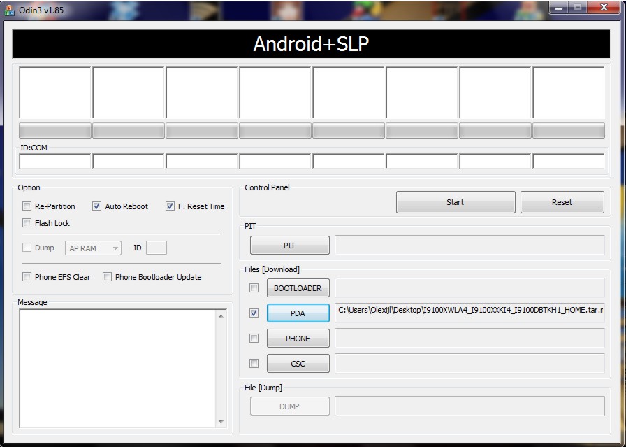

  • Launch Odin with admin rights
  • Go to "PDA" and choose I9100XWLA4_I9100XXKI4_I9100DBTKH1_HOME.tar.md5 file
  • please connect your phone now via USB
  • now press Start and wait. After successful reboot of your phone disconnect the phone from your PC

  • Go to "PDA" and choose your Siyah-v2.5.2.tar file
It should look like this (old screenshot).
