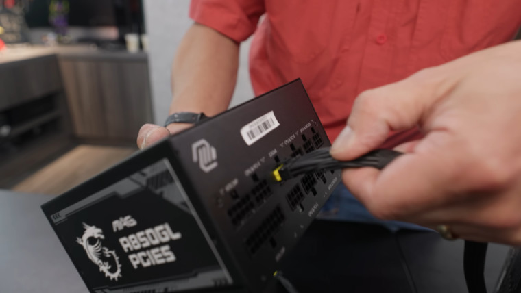

    MSI recently came up with a simple yet somewhat effective solution for the issue, where it showed off bright yellow coloured 16-pin power connectors. The idea is that the yellow-coloured pins will not be visible to the user once the connector is properly seated (via PCWorld YouTube).
