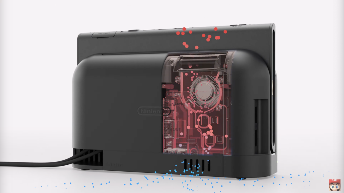

    Glancing at those numbers, it's easy to pick out a large difference between the system's performance in docked and undocked modes; its GPU clock and memory bandwidth both increase substantially when plugged into a TV. Those differences could help explain why the Switch 2 dock uses an active cooling fan, unlike the much simpler TV-connection dock on the original Switch.
