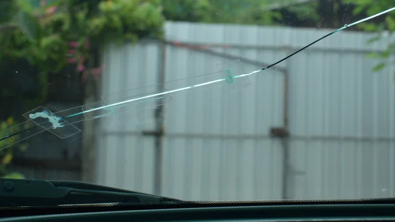

Tape is one of the easiest and most efficient ways to stop a windshield crack from spreading, and it's likely something you already have at home or in the office. Ideally, you should be using clear tape that allows you to see out of your windshield and doesn't impact your visibility of the road. Clear packing tape is the best solution, as this is stronger than cellophane tape, and will keep out dirt, debris, and moisture.
If you have a cracked windshield, follow these steps to seal it with packing tape:
  1. Remove dirt from the crack by gently wiping the area with a dry microfiber cloth or towel. This will make it easier for the tape to stick.
  2. Don't apply water or glass cleaner, as this can seep into the glass and make repairs difficult.
  3. Take a strip of clear packing tape and apply it evenly over the crack. Ideally, use longer strips of tape and avoid layering.
Once you've applied the tape, you should get your windshield professionally repaired or replaced as soon as possible. The tape is only a temporary fix, and won't stop the crack from spreading if you drive over a bumpy road or your car is exposed to extreme temperatures. You can use duct tape in a pinch, but only if the crack is an area that doesn't obstruct your view.
