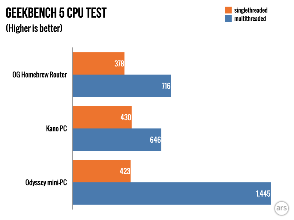

We tested the Odyssey against our own original gangster Homebrew Router from 2016, this year's Kano PC, and Walmart's cursed EVOO EV-C-116-5 laptop. The Odyssey, OG Homebrew, and Kano PC are all Celeron-based low-power systems; the AMD A4-9120 powered EVOO should be in the same class but isn't, due to its massive factory underclocking.
When we thoroughly tested routing performance with challenging, small-packet workloads back in 2016, we found that the Celeron 1037U in the Homebrew was more than sufficient to sling packets at a full 1Gbps on a bare Ubuntu installation. When we tested pfSense, the more user-friendly and full-featured router distribution didn't do so well.
Although Kano PC's N4000 is four years newer than the Homebrew's 1037U, with double the cores and threads, it isn't significantly faster. Odyssey's J4105 is a powerhouse by comparison—it's overwhelmingly faster than either in multi-threaded tests, and a little faster single-threaded to boot.
Although we haven't directly tested the Odyssey as a dedicated router, its benchmarks lead us to believe it would do very well. We suspect that even when running pfSense or opnSense, it should hang pretty well with the original Homebrew running vanilla Ubuntu.
