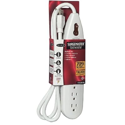

RadioActive Posted October 24, 2009 Share Posted October 24, 2009 On 10/24/2009 at 3:16 PM, d3v said: yes.. a UPS. Don't suppose they make backpack-sized ones?I'll be buying a few big ones soon as I'm setting up a net cafe for a friend.not a big fan of sarcasm but regardless, perhaps something like this should suite your needs? Of course there are better products, just search for "surge protection" and see what your options are. I hope that helps.http://www.amazon.com/Belkin-SurgeMaster-6-Outlet-Protector-Joules/dp/B000068CNT/ref=sr_1_26?ie=UTF8&s=electronics&qid=1256402586&sr=8-26 Link to comment Share on other sites More sharing options...
myidisbb Posted October 24, 2009 Share Posted October 24, 2009 i like belkin surge protectors. get the ones with cable and highband phone line protection too. connect cable or dsl from wall to the SP first then to modem then computer or route. all 3 hardware on a SP also. normal price looking at $40-$50, dont waste money on home theater monster that cost $99 or more. Link to comment Share on other sites More sharing options...
LeetPirate Posted October 24, 2009 Share Posted October 24, 2009 I would never recommend Belkin. The last time I depended on belkin, the lightning hit and my belkin surgemaster caught on fire. LOL. I opened it and realised it was the shittiest design I ever saw. The pcb used the thinnest possible trace for the path that is supposed to carry the surge current and it burned out that part of the trace with the excessive current. Belkin is not a power company, they know nothing, they are just a brand name buying cheap shit from china.APC is supposed to be good but they are like intel, lots of marketing while hiding the true data sheets. APC UPS uses the lamest charging algorithm, a linear one. Anyone with a bit of knowledge on the charging process knows that the best charging algorithm is a multi-stage algorithm with pulse charging, which you will never find in APC domestic products. Maybe they have it in their industrial products but certainly not the ones for home use. Total waste of money. They do that on purpose to guarantee that your battery lasts the set period of them so you will pay them loads of money to have it replaced.While I have not tested every brand on the planet, one that has proven itself to me is Powercom. Sure they don't do lots of marketing, and their website isn't as flashy as APC but their engineering design is excellent. Under the hood of a Powercom ups is how a ups should be. They use multi-stage pulse charging, and intelligent self discharge protection, advanced battery management, conditioning etc etc. Great value without the overpriced fees for brand name.My batteries in my APC are dead for a second time and the ones in my Powercom are still holding out even after 6 years. I have stopped trusting brand names for reliability, I test and use the products that actually get the job done. Back in the day I used to trust intel, got screwed with their prescott (aka presHOTT) core; trusted Belkin, house almost caught on fire; trusted APC, UPS kept switching between battery and AC when the usb cord is connected till the battery dies, stupid code, lame charging, the list is endless; trusted Seagate, got screwed with their faulty firmware and cheap drives. So many others but I won't list them all.Best of luck with getting the pcb replaced, removing it does not expose the disk, but there are alot of things that could go wrong or break so be careful. Be sure you get the right tool with enough torque to turn the screws. Link to comment Share on other sites More sharing options...
