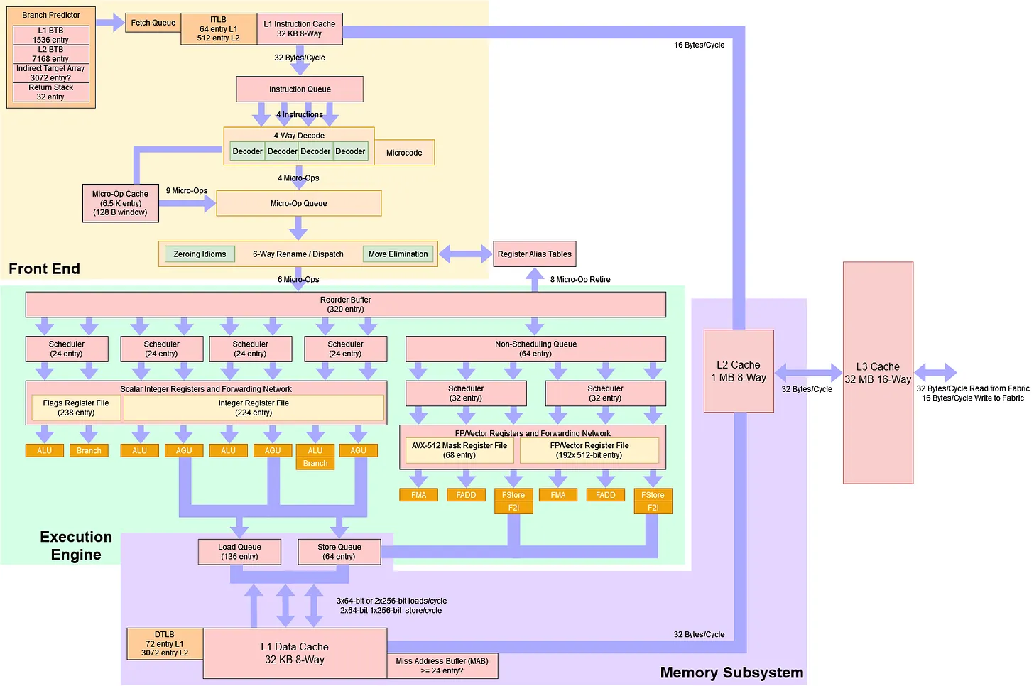

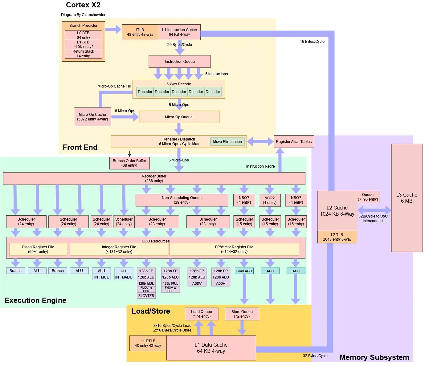

    Here are block diagrams outlining the microarchitecture of two unrelated CPUs, developed by different companies, running different instruction sets. Neither CPU core is simple, but both have a lot in common.
    f2927adf-122b-43ca-b6a3-c92a8f2f4435_163
    AMD’s Zen 4 architecture. I drew the diagram from AMD’s figures, with some details figured out through microbenchmarks.
    7ffd1397-cbf2-46ee-ba11-80c9270dfcdc_139
    Arm’s Cortex X2 architecture. I drew the diagram mostly from microbenchmark results to infer architectural details.
    Cortex X2 and Zen 4 both use superscalar, speculative, out-of-order execution with register renaming. Beyond the core, both Cortex X2 and Zen 4 use complex, multi-level cache hierarchies and prefetchers to avoid DRAM access penalties. All of these features have everything to do with maximizing performance, especially as compute performance keeps outpacing DRAM performance. They have nothing to do with the instruction set in play.

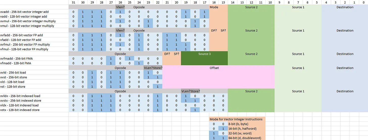

    Decoding is expensive for RISC architectures too, even if they used fixed length instructions. Like Intel and AMD, Arm mitigates decode costs by using a micro-op cache to hold recently used instructions in the decoded internal format. Some Arm cores go further and store instructions in a longer, intermediate format within the L1 instruction cache. That moves some decode stages to the instruction cache fill stage, taking them out of the hotter fetch+decode stages. Many Arm cores combine such a “predecode” technique with a micro-op cache. Decode is expensive for everyone, and everyone takes measures to mitigate decode costs. x86 isn’t alone in this area.
    e15eedaf-b2b8-4c36-992a-4d0299d35352_157
    Some observed LASX vector extension instruction encodings from LoongArch, which descended from MIPS.
    Hackaday further takes issue with instruction set extensions and increasing instruction count, but neither are distinctly x86 features. ARM has similarly been through numerous revisions and extensions. Where x86-64 has SSE, AVX(2), and AVX-512 vector extensions, 64-bit ARM (aarch64) has ASIMD, SVE, and SVE2 vector extensions. MIPS has a similar story with a MSA SIMD extension. MIPS didn’t get more extensions as ARM and x86 did, but that’s because no one was using it anymore. LoongArch is derived from 64-bit MIPS, but uses incompatible instruction encodings. Loongson has extended LoongArch with the LSX and LASX vector extensions.

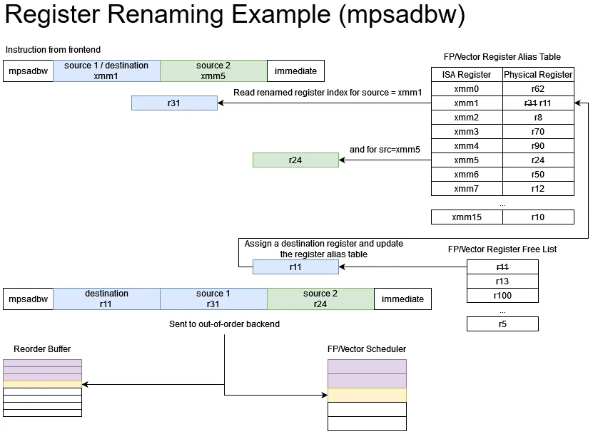

    Next, Hackaday focuses on x86’s mpsadbw instruction, noting that it’s doing “at least 19 additions but the CPU runs it in just two clock cycles.” The author should think of why that instruction exists by looking at its use cases. Video codecs strive to efficiently use bandwidth and disk space by representing most frames in terms of how they differ from previous ones, rather than storing the entire frame. Calculating the sum of absolute differences (SAD) is a good way to see how much a block has changed, and is a vital part of video encoding. ARM has similar vector instructions.
    ca122857-c8e5-40a7-878d-518ec4312ebe_831
    The author then suggests adding more instructions (like mpsadbw) makes register renaming and instruction scheduling more complex. That makes intuitive sense, but doesn’t match reality. Even though mpsadbw does more low-level operations, it only requires two register inputs and one destination register. The renamer therefore only needs to read two values from the register alias table to determine where to get inputs from, and allocate one free register to store the result.

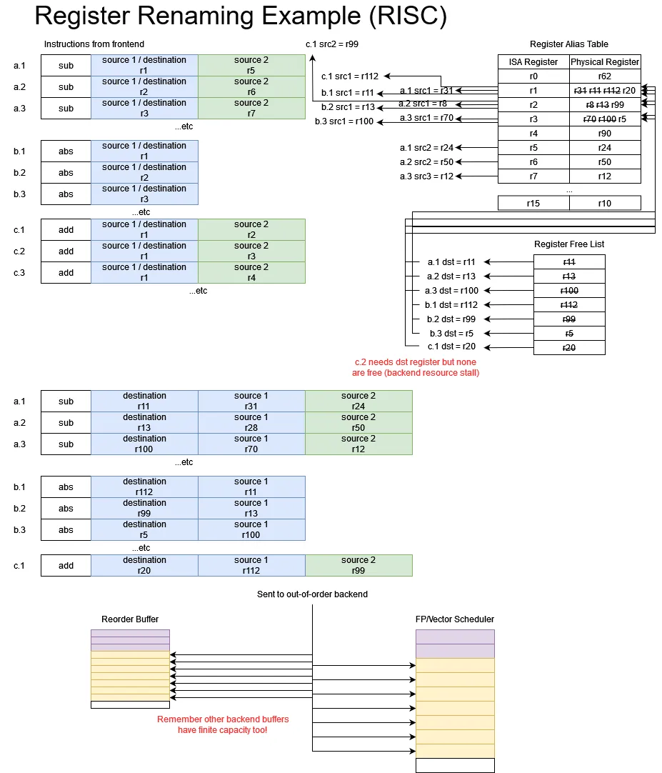

    The author looked at an instruction, noted that it does multiple calculations, and therefore concludes it looks scary, but let’s consider the alternative. We can perform the vector SAD calculation with RISC-like instructions (excluding the selection part of mpsadbw). Each simple RISC instruction would require the same degree of register renaming as the “complex” msadbw instruction. Each input requires a lookup in the register alias table, and a free register has to be allocated to hold each result.
    cdfb317c-24d7-4c35-a77f-ca7a8e9fceb1_927
    Only covering the sum of absolute differences part, and not even all of that because there are already too many overlapping arrows
    Contrary to the author’s claims, complex instructions actually lower register renaming and scheduling costs. Handling an equivalent sequence of simple instructions would require far more register renaming and scheduling work. A hypothetical pure RISC core would need to use some combination of higher clocks or a wider renamer to achieve comparable performance. Neither is easy. As shown above, the same register may be renamed multiple times in quick succession, so a wider renamer must cope with a longer potential dependency chain. Beyond a wider renamer, a pure RISC design would need larger register files, schedulers, and other backend buffers to mitigate the impact of having to track more instructions.

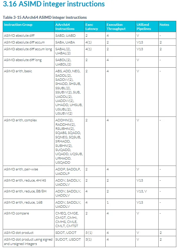

    Of course, people designing ARM CPUs understand the importance of efficiently using fetch/decode/rename bandwidth. They also understand the importance of economizing usage of backend resources like register files and scheduler entries. That’s why ARM today has plenty of complex instructions that perform many low-level operations under the hood. Vector instructions may be the most prominent example, but it’s easy to find other examples, too. aarch64 has long supported loading a value from memory with an address generated by shifting an index register, and adding that to a base register. That’s a chain of three dependent operations under the hood, but it simplifies array addressing.
    On the other side, simple instructions often make up the majority of an executed program’s instruction stream. That’s especially applicable for programs that are hard to parallelize, like file compression or web browsing. CPUs today therefore have to be good at executing simple operations quickly. At the same time, they benefit from having complex instructions to speed up specific workloads.
    fd857156-d3fd-4049-9cc0-5932c022adc3_615
    A page from Arm’s Cortex X2 optimization manual, showing the core doing complex operations
    (RSUBHN2 for example could do 16 8-bit subtractions, select the most significant half of each
    result, and perform rounding, all over two cycles)

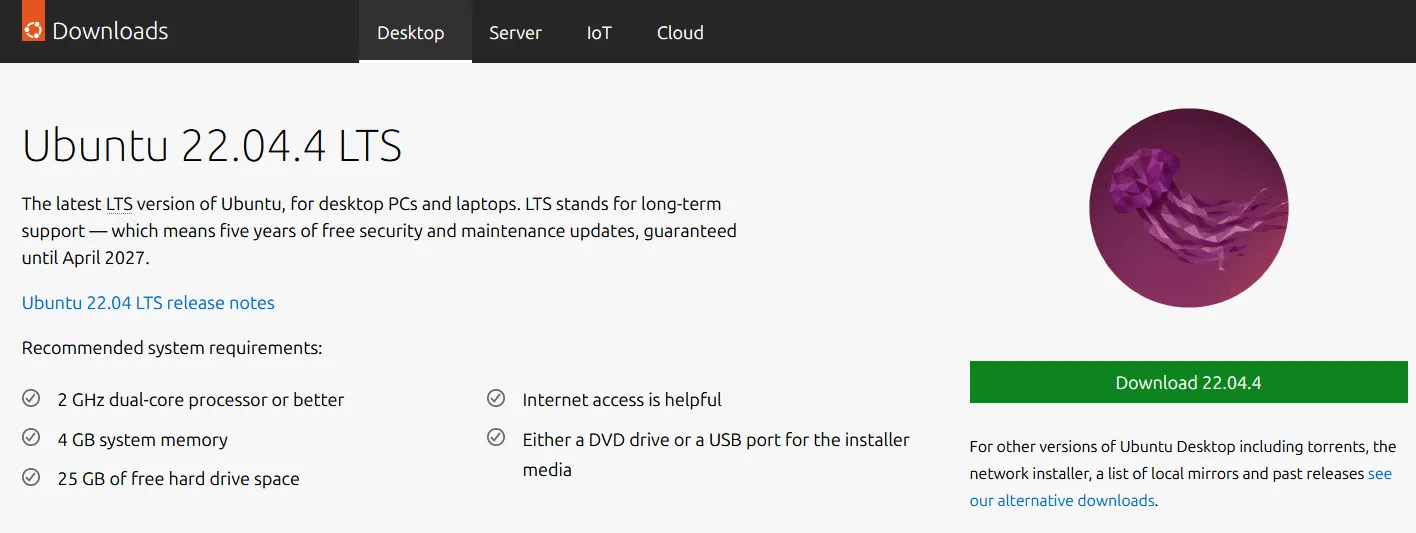

    Hackaday mentions x86’s real mode, leading to another important point: compatibility. When gushing over different CPUs and the performance they offer, it’s all too easy to forget what that performance is needed for: running software. If a CPU doesn’t run the software you need, it’s a tiny brick. x86-64 CPUs keep real mode around so that operating systems can keep booting in the same way. Today, you can create a single OS install drive that works on a modern Zen 4 system, a Phenom system from 15 years ago (just make sure you use MBR boot) and everything in between. That 15-year-old Phenom system can run recent operating systems like Windows 10 or Ubuntu 22.04. Of course there are limits, and you can’t run Windows 10 out of the box on a Northwood Pentium 4. But real mode support is part of what makes the same OS boot code work across so many CPUs. It’s part of the PC compatibility ecosystem that gives x86 CPUs unmatched compatibility and longevity.
    e0897469-a059-433d-97b6-26b3fb7c85b8_141

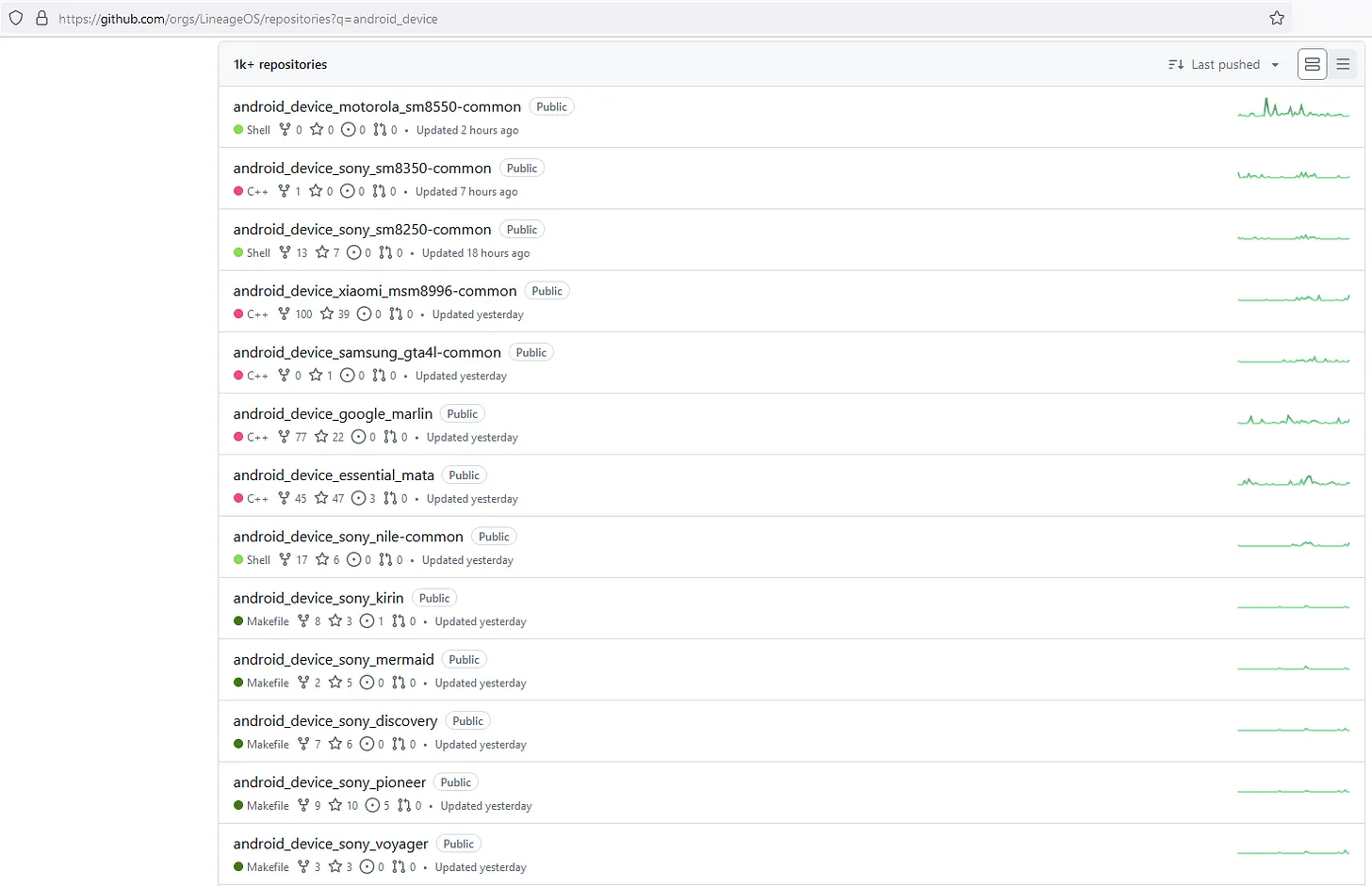

    Other ecosystems present a sharp contrast. Different cell phones require customized images, even if they’re from the same manufacturer and released just a few years apart. OS updates involve building and validating OS images for every device, placing a huge burden on phone makers. Therefore, ARM-based smartphones fall out of support and become e-waste long before their hardware performance becomes inadequate. Users can sometimes keep their devices up to date for a few more years if they unlock the bootloader and use community-supported images such as LineageOS, but that’s far from ideal.
    b99cf5d1-abaa-4ca1-b5de-426541e020e2_147
    The LineageOS project has over 1000 repositories, because image builds for each device have to be handled separately.
    Intel and AMD correctly realized that spending extra effort on compatibility is worthwhile. Doing so streamlines software distribution, and lets users hang onto their expensive hardware for longer.
