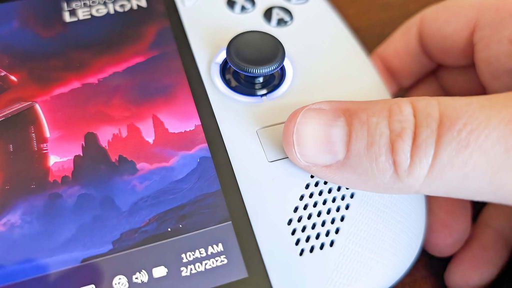

    A thumb touching the Lenovo Legion Go S touchpad.
    Capacitive touchpads work even when they're super tiny.
    (Image credit: Rebecca Spear / Windows Central)

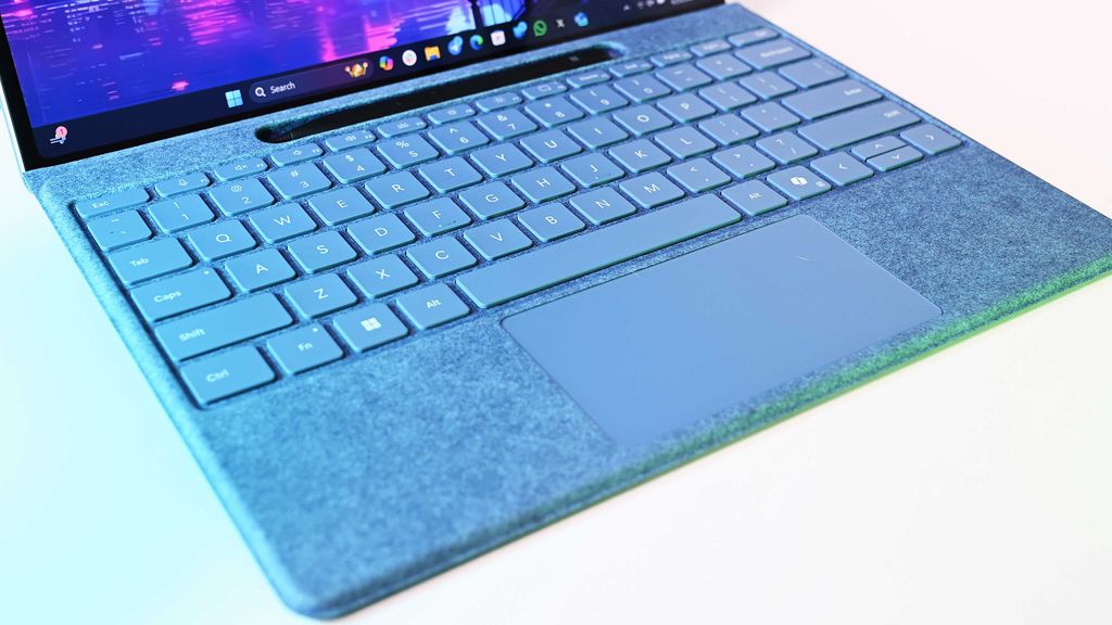

    Microsoft Surface Pro 11 with Qualcomm Snapdragon X Elite
    You can even find haptic touchpads in thin, wireless keyboards like the cover for the Surface Pro 11.
    (Image credit: Daniel Rubino)
    Haptic touchpads still use a capacitive touch layer, but replace the mechanical buttons with two elements: force sensors and haptic actuators.
    Instead of relying on inconsistent mechanical buttons that wear out over time, haptic touchpads use force sensors to accurately detect how much pressure is being applied to the touchpad, meaning they can differentiate between soft and hard taps and presses.
    Normal "soft" interactions will feel similar to a traditional touchpad (with no feedback), but deeper presses will use haptic actuators to "vibrate" the touchpad to simulate a button press.
    The use of haptic actuators means "button presses" will feel identical across the entire surface of the touchpad, but companies can use this feedback system for other purposes, too, like simulating the click of a scroll wheel or providing unique tactile feedback for gestures, shortcuts, and more.
    Haptic touchpads can also use force sensors to detect more than two levels of pressure, opening up more possibilities for user customization and more advanced features.
    Technically, haptic touchpads do move very slightly to detect pressure and isolate the haptic vibrations, but it's not something you'd ever notice. In use, haptic touchpads are an unmoving glass or acrylic surface, and that means disabling them doesn't leave you with useless buttons.

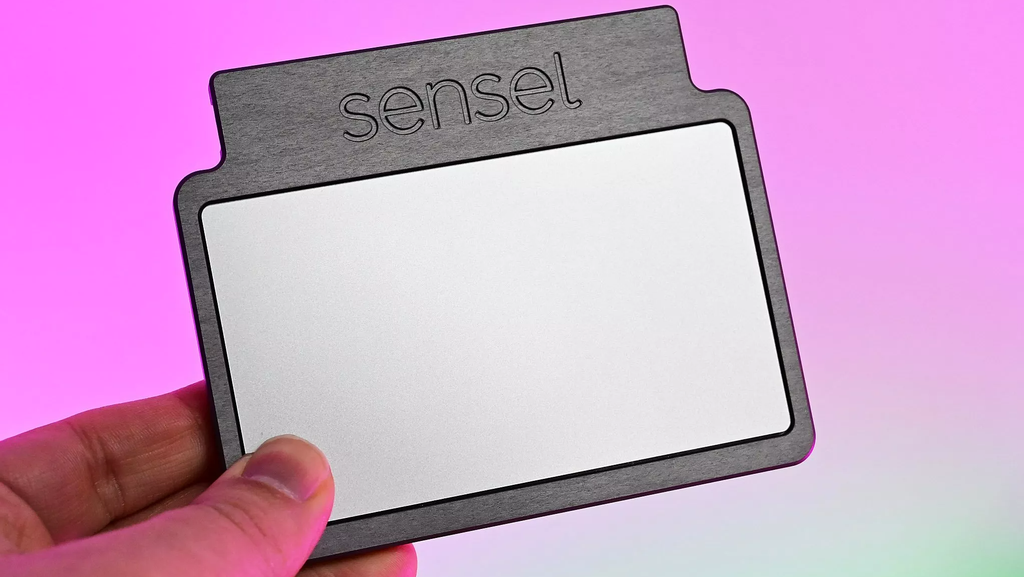

    Sensel Haptic Trackpad
    Sensel is the gold standard for haptic touchpads right now.
    (Image credit: Future)
    How do the haptics work, though? There are several different kinds of haptic actuators in different forms of technology, but two are used in haptic touchpads.
    Linear Resonant Actuator (LRA) motors are the most common in personal technology, like smartphones and wearables, and use electromagnets. Basically, a copper coil is wrapped around a magnet, and running a current through that coil can move the motor back and forth at a high rate.
    LRAs are efficient and have a rapid response time, and can vary in cost wildly between dirt-cheap motors in budget devices and the high-end, proprietary solutions used by companies like Apple and Sensel (one of the leaders in haptic touchpads).
    Other haptic touchpads may use Piezoelectric actuators, which run an electric current through small ceramic disks to provide highly precise haptic feedback. These actuators are more common in medical devices and other technologies where accuracy is crucial, but are more expensive than LRAs and are quite fragile.
    There are pros and cons to either, but the end result is more or less the same.

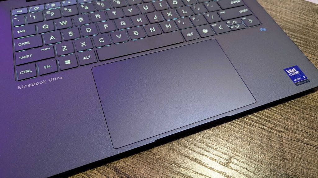

    Image of the HP EliteBook Ultra 14 (G1i)'s haptic touchpad.
    Even if you don't care about gestures and shortcuts, a more customizable user experience is worth it on its own.
    (Image credit: Windows Central | Zachary Boddy)
    In a word: yes. You have to use haptic touchpads to really understand, but they're simply better. My first experience with haptic touchpads was with the HP Spectre x360 14 (2024) I reviewed, and I've wanted the technology in every single laptop I've reviewed since.
    Haptic touchpads can make our laptops thinner and more durable, sure, but there are legitimate usability advantages. Traditional touchpads have improved thanks to Microsoft Precision drivers improving gesture support, but are ultimately limited by simple mechanical buttons.
    Haptic touchpads keep all the advantages of traditional touchpads, but can perfectly simulate those mechanical buttons across the entire surface. On top of that, haptic touchpads can provide tactile feedback for gestures and enable new gestures, like subtly clicking as you "scroll" to change your volume or brightness levels.
    More than that, haptic touchpads' ability to detect pressure levels means you can customize different shortcuts and gestures depending on how hard you press. The possibilities are endless, only limited by the imagination of companies and users.
    Finally, haptic touchpads are far more customizable. You can configure how much force you need to activate them, and tweak the haptic feedback to your preferences. You can even disable the haptics entirely and be left with a purely unmoving, capacitive touchpad.

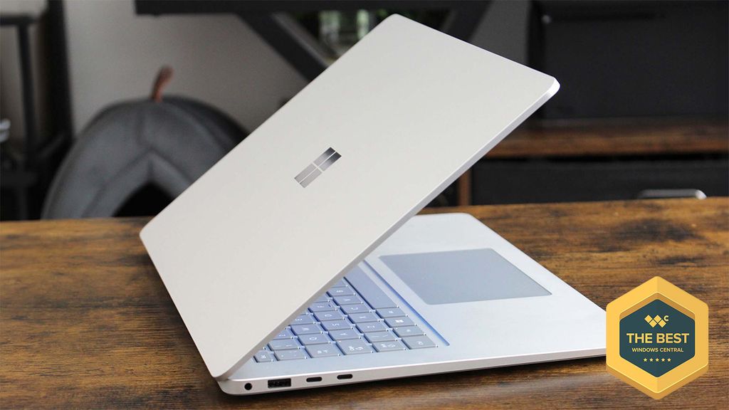

    Surface Laptop 7
    The Surface Laptop 7 is one of the best Windows laptops you can buy right now, and the haptic touchpad is part of that.
    (Image credit: Zac Bowden | Windows Central)
