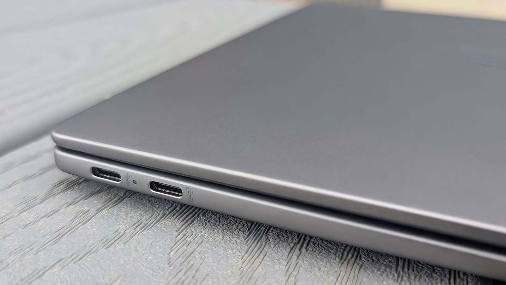

    HP OmniBook X 14's two USB-C ports.
    A look at two USB-C ports on HP's OmniBook X 14. Can you tell me which standard they support just by looking at them?

    The problem boils down to USB-C's inequality. Many laptop makers slap a USB-C port or two onto a PC without divulging much more information beyond its numbered standard, and even then, it's difficult to tell its true capabilities.

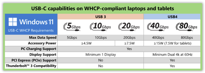

    These promises come with several minimum capabilities for each USB-C version. The Microsoft blog post has a neat little table that lays them out.
    WHCP compliance for USB-C in Windows 11
    Microsoft lays out minimum USB-C capabilities found in WHCP-compliant Windows PCs.
    (Image credit: Microsoft)
    The enforcement of these minimums through the WHCP qualification system leads to several conclusions.
    Most importantly, you'll be able to trust that your USB devices will work without issue, thanks to Microsoft's new requirement of USB-IF certified silicon inside the laptop.
    Every USB-C port on a certified PC now requires USB Power Delivery capabilities so that there's no inconsistency with what can charge and what cannot.
    Next up is external display support; DisplayPort Alt Mode is now required for all USB-C ports. Ports are required to be VESA certified, so you can expect to plug in a screen without issue.
    And finally, a Microsoft driver stack requirement ensures that your PC is always getting the latest USB driver updates to keep everything running smoothly.

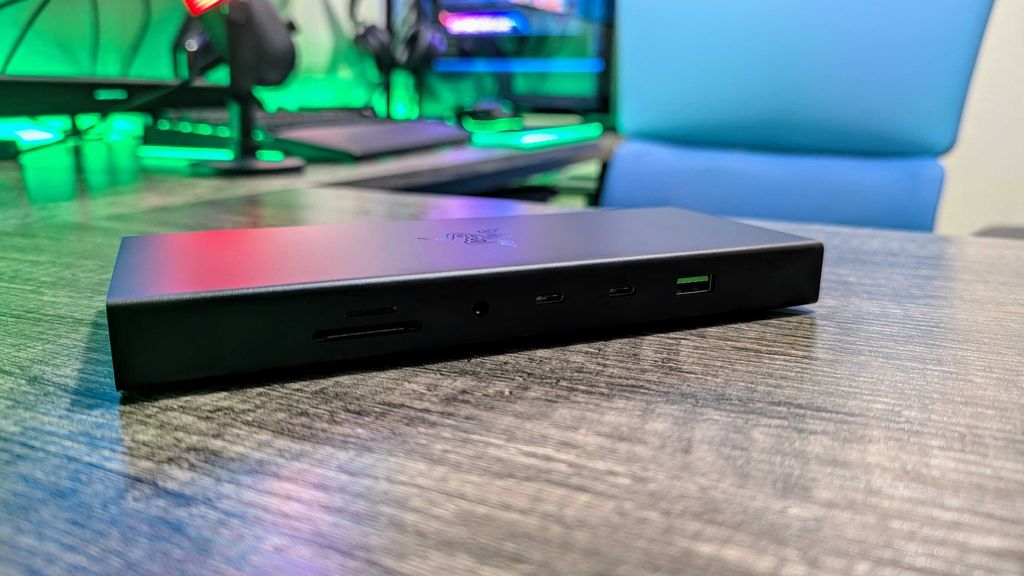

    The Razer USB4 Dock on a desk with its front forts facing forward.
    Accessories like the Razer USB4 Dock don't require Intel's Thunderbolt branding to deliver awesome performance.

    USB4 40Gbps connections in new Windows laptops will now require full compatibility with USB4 and Thunderbolt 3 accessories. If your laptop is advertised as having a USB port with 40Gbps performance, you can expect it to be able to sustain that speed.
    Beyond that, WHCP certification covers 80Gbps USB4 ports, requiring them to offer 80Gbps transfer speeds in both directions, as well as an asymmetric 120Gbps / 40Gbps mode made especially for high-res external display.
