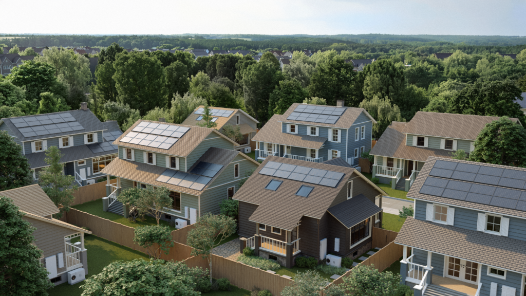

    An illustration of standalone suburban homes set against a backdrop of trees. Each home has rooftop solar panels and a rectangular XFRA node along the outside wall on the ground, along with a wall-mounted smart panel and backup battery.
    The startup SPAN envisions a 100-home pilot deployment of XFRA nodes in 2026 followed by rapid scaling in 2027.
