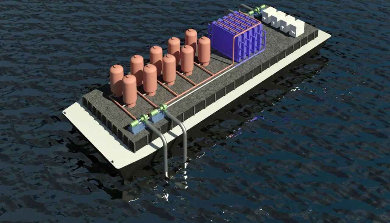

    Initially, the system can use existing or planned infrastructure that already processes seawater, such as desalination plants, but the system is scalable. This rendering shows how the new method could also be used by ships and offshore platforms. Credit: Courtesy of the researchers

    Initially at least, the idea would be to couple such systems with existing or planned infrastructure that already processes seawater, such as desalination plants. “This system is scalable so that we could integrate it potentially into existing processes that are already processing ocean water or in contact with ocean water,” Varanasi says. There, the carbon dioxide removal could be a simple add-on to existing processes, which already return vast amounts of water to the sea, and it would not require consumables like chemical additives or membranes.
    “With desalination plants, you’re already pumping all the water, so why not co-locate there?” Varanasi says. “A bunch of capital costs associated with the way you move the water, and the permitting, all that could already be taken care of.”
    The system could also be implemented by ships that would process water as they travel, in order to help mitigate the significant contribution of ship traffic to overall emissions. There are already international mandates to lower shipping’s emissions, and “this could help shipping companies offset some of their emissions, and turn ships into ocean scrubbers,” Varanasi says.
    The system could also be implemented at locations such as offshore drilling platforms, or at aquaculture farms. Eventually, it could lead to a deployment of free-standing carbon removal plants distributed globally.
