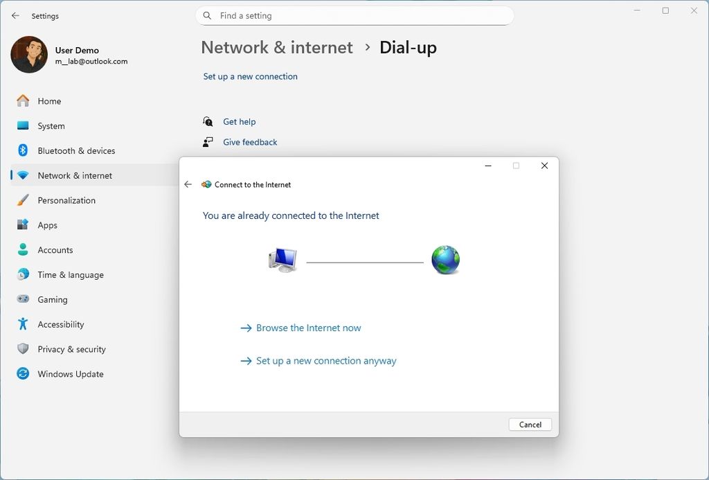

    Windows 11 Dial-Up settings
    (Image credit: Mauro Huculak)
    In the official release notes for the "2026-01 Security Update (KB5074109) (Build 26200.7623)," Microsoft explicitly states that the update removes several legacy modem drivers: "agrsm64.sys (x64), agrsm.sys (x86), smserl64.sys (x64) and smserial.sys (x86)."
    As a result, modems that depend on these specific drivers no longer work in the operating system. However, because this change was mentioned only in the update notes, many people didn't see it coming.

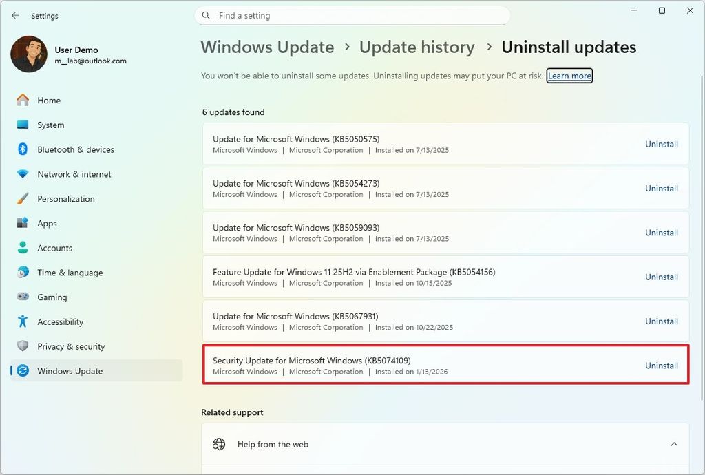

    Windows 11 uninstall KB5074109
    If you have a device that depends on these drivers, you can extend their functionality for a little longer by uninstalling the update KB5074109 and pausing or . However, remember that it's not recommended to operate an unpatched operating system, but you can use this as a temporary fix until you find a more permanent solution.
