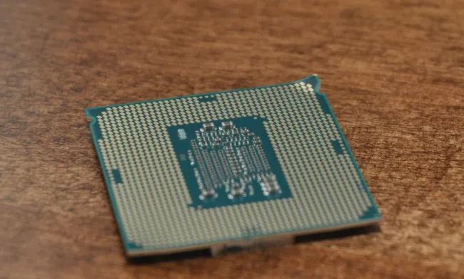

    image.php?id=2017&image=bent_kaby_1_med
    Not directly related: I Bent A Kabylake CPU & It Still Works
