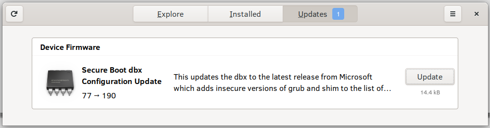

    Eclypsium explains that Linux users must also update the UEFI Secure Boot DBX (revocation list) to include the hashes of the vulnerable Shim software and sign the patched version with a valid Microsoft key.
    To do that, first upgrade to Shim 15.8 and then apply the DBX update using the 'fwupdmgr update' command (needs fwupd).
    Command to update DBX (Eclypsium)
    Some Linux distributions offer a GUI tool to perform this update, so make sure to check on your package manager before delving into the terminal.
