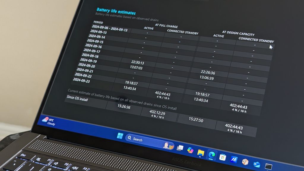

    ASUS Zenbook S 14 with Intel Core Ultra (Series 2)
    Silicon carbon could mean bigger batteries in our laptops.
    (Image credit: Ben Wilson | Windows Central)
    Silicon-carbon batteries are an upgrade over traditional lithium-ion cells overall, but the benefits are largely centered around one thing: greater cell density. Basically, silicon-carbon has a much higher capacity in the same volume (around 20-30% more), allowing for bigger batteries that aren't actually bigger.

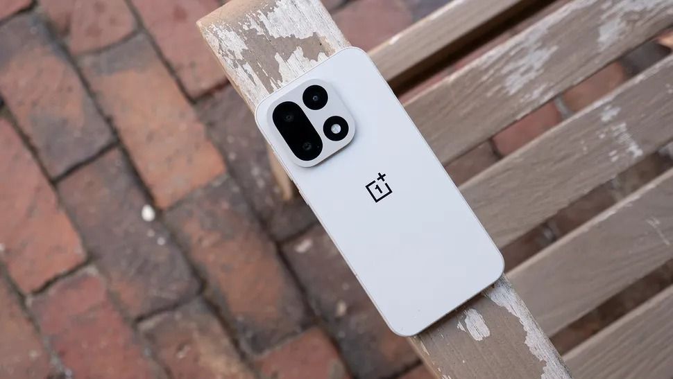

    Image of the OnePlus 15.
    The OnePlus 15 has one of the largest batteries I've ever seen in a smartphone.
    (Image credit: Android Central)

    Easily the best example of a smartphone truly taking advantage of silicon-carbon technology (that many of us will actually be able to buy) is the OnePlus 15. This flagship smartphone boasts an insane 7,300mAh battery split between two 3,650mAh cells, with up to 120W wired charging and 50W wireless charging.
    For comparison, the Samsung Galaxy S25 Ultra is bigger, heavier, and more expensive, and only has a 5,000mAh battery with 45W wired charging and 15W wireless charging. That's a big difference. You can read more about the OnePlus 15 at AndroidCentral.com, our sister site.
