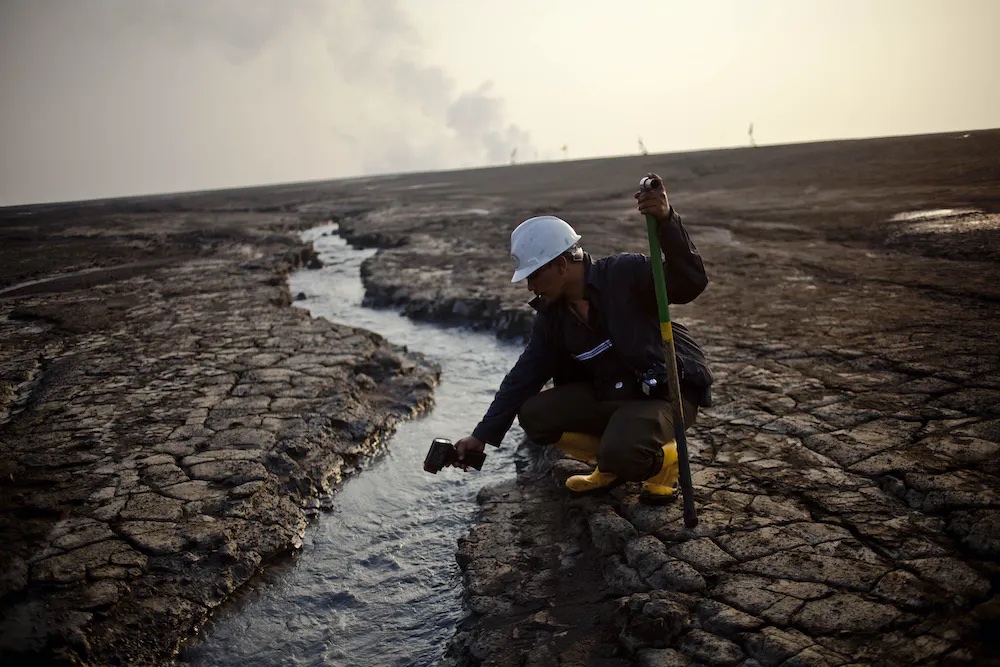

    Enlarge / An officer of the Sidoarjo Mud Prevention Agency checks the water temperature of mud near the Lusi mud volcano in 2011.
