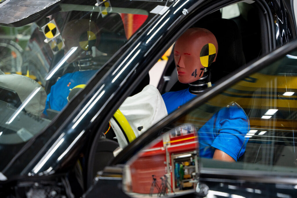

    Volvo crash test dummies
    Every day, dummies like these get smashed to make Volvos safer.
    Load limiters control how much force the safety belt applies to the human body during a crash. Volvo’s new system pushes the load-limiting profiles from three to 11, marking a major increase in adjustability. It’s kind of like an audio system, Ljung Aust muses. A sound system with 10 discrete steps up the volume ladder offers varied profiles along the way, while one with only one or two steps addresses fewer preference levels.
    Using data from exterior, interior, and crash sensors, the car reacts to a collision in milliseconds—less than the blink of an eye, Ljung Aust says. In the case of a crash, it’s critical to hold the hips into the car, he explains, but the upper body should fold forward in a frontal crash in a nice, smooth motion to meet the airbag. Otherwise, the body is exposed to the same force as the slowing car.
    Tempering that motion means adjusting for a passenger’s size to avoid injury; for instance, if the sensors detect a larger occupant in a severe crash, it’s designed to reduce the risk of head injury by using a higher belt load setting. Conversely, a smaller passenger in a lesser fender bender gets a lower belt load setting to reduce the incidence of rib fractures. Haglund notes that while one might make assumptions about what body type is more vulnerable in a crash, it has more to do with the kind of crash itself.

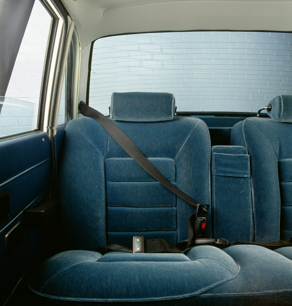

    A rear seat belt in a Volvo
    Volvo introduced the first rear three-point belts in 1972. Wearing a seatbelt in the back of a car still isn’t mandatory in all 50 US states, in 2026.
