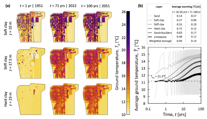

    Using the Chicago Loop district as a case study, and three years of data from a network of wireless temperature sensors, civil engineer Alessandro Rotta Loria of Northwestern University in Illinois built a 3D computer model to simulate how rising temperatures have impacted the subsurface environment.
    His simulations span a century, from 1951 (the year Chicago completed its subway tunnels) to 2051, and reveal "a silent yet potentially problematic impact of subsurface urban heat islands on the performance of civil structures and infrastructures," Rotta Loria writes in his peer-reviewed paper.
    TemperatureVariationsBelowChicagoLoop-72
    Ground temperatures (a) at three depths beneath Chicago's Loop district. Darker colors represent higher temperatures. Average temperature trends (b) for different soil types. (Rotta Loria, Communications Engineering, 2023)

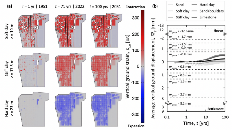

    Buildings are unlikely to collapse because of slow-moving, heat-related deformations, Rotta Loria says. But subtle subsurface changes of only a few millimeters can strain or mobilize foundations and affect the durability or performance of construction materials over time.
    "The ground [in Chicago] is deforming as a result of temperature variations, and no existing civil structure or infrastructure is designed to withstand these variations," explains Rotta Loria who found Chicago's ground temperatures are currently warming at around 0.14 °C per year.

    GroundDeformationOfChicagoLoop-741x415.p
    Vertical strain variations on the ground beneath Chicago, at varying depths (a) and times (b). (Rotta Loria, Communications Engineering, 2023)

    In Rotta Loria's study, he found larger ground temperature variations in the northern, more densely built part of Chicago's Loop district compared to its sparser, southern end.
    Averaged across the whole district, temperatures within distinct soil layers varied by about 1-5 °C (1.8-9 °F). Depending on the soil type, warmer temperatures caused displacements of 8-12 millimeters under various buildings, the modeling found.
    While a few millimeters might sound small, and buildings are designed to tolerate some flex, older buildings and other infrastructure were not built to withstand temperature variations seen today, Rotta Loria says.
    "It's very likely that underground climate change has already caused cracks and excessive foundation settlements that we didn't associate with this phenomenon because we weren't aware of it," he says.
