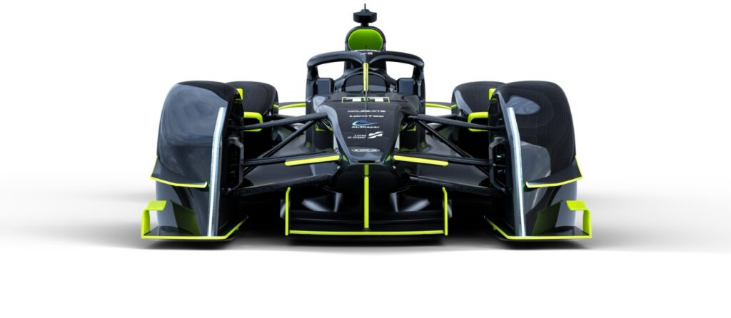

    The DRG-Lola is much closer to reality than that 2020 concept; di Grassi has relied on existing battery and motor technology, rather than some uninvented unobtanium to make it all work. It generates 804 hp (600 kW) from a pair of electric motors driving the front and rear axles and is powered by a 60 kWh battery pack that’s arranged in modules on either side of the driver’s cockpit.
    Unlike an F1 or Formula E car, the wheels are covered, similar to the Adrian Newey-designed Red Bull X2010 and X2019 cars in the Gran Turismo series—doing so seriously reduces the car’s drag coefficient and therefore allows for significantly longer race distances, as the car needs to use less energy to push itself through the air.

    A render of the DRG-Lola from the front 3/4s
    The car's floor extends quite far forward.
