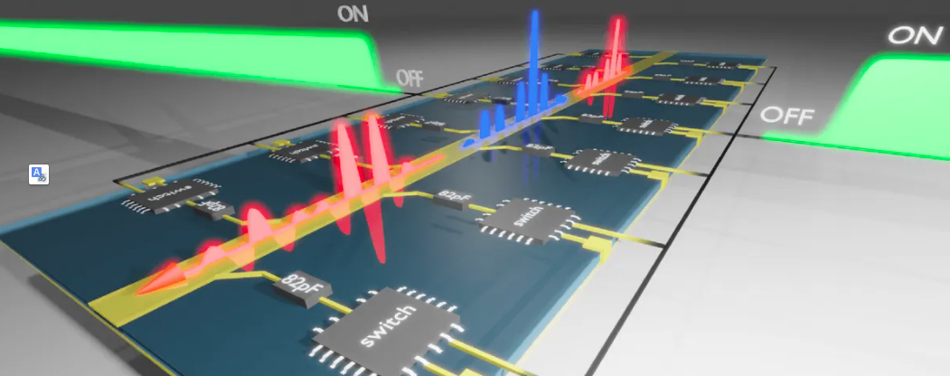

    In a spatial reflection (a) we see our face reversed left to right. In a temporal reflection (b) we would see the back of our head because the wave order is reversed, and the colors would be changed thanks to frequency shifting. (C) Schematic of the experimental set up, with a control signal changing the medium through which a wave passes fast enough to induce time reflection. Image credit: Andrea Alu
    The team turned to metamaterials, substances with properties never seen in nature.
    “Our idea was to avoid changing the properties of the host material, and instead create a metamaterial in which additional elements can be abruptly added or subtracted through fast switches," Xu said.
    The team confirmed their achievement by combining time-reflected and time-refracted versions of the same signal and observing the interference.
