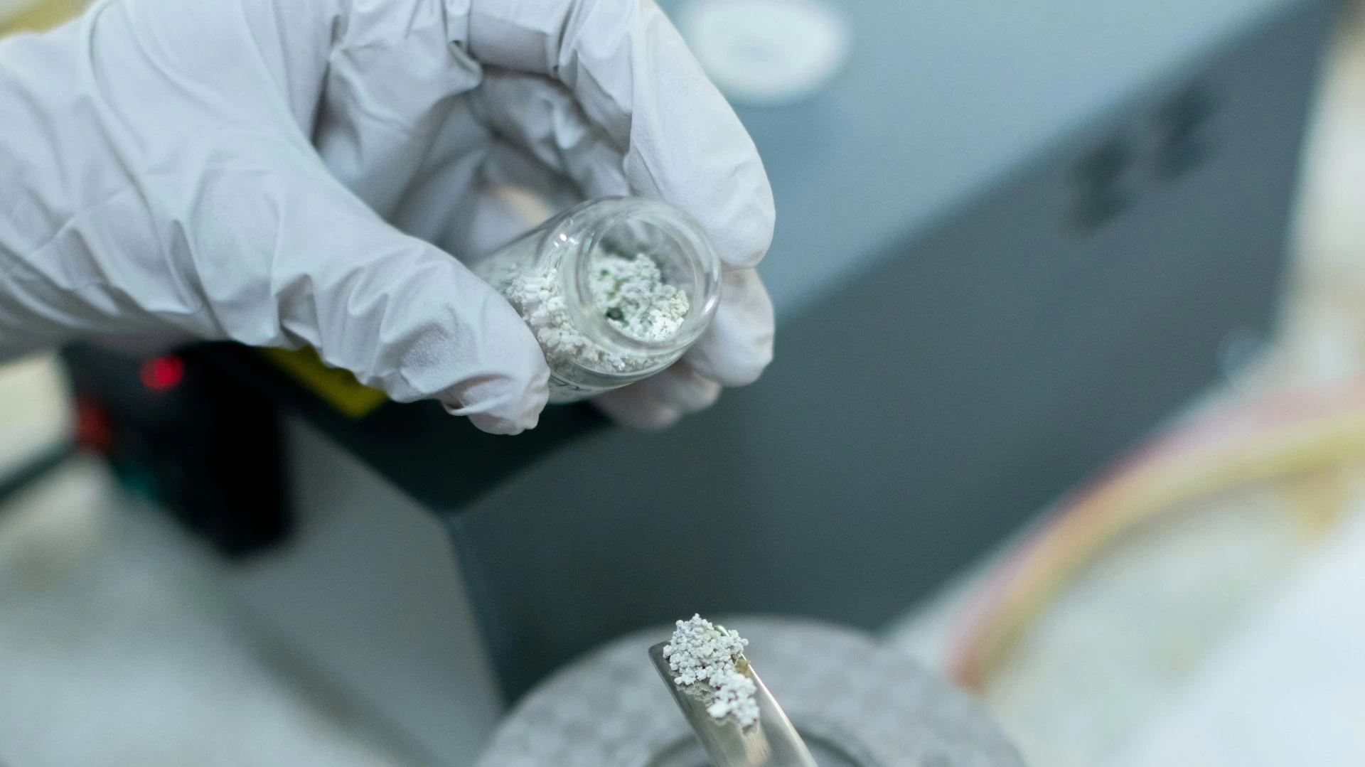

    A research group at the Daegu Gyeongbuk Institute of Science and Technology (DGIST), led by Professor Su-Il In, has developed a new type of nuclear battery called a perovskite betavoltaic cell (PBC), which could power small devices for decades without the need for recharging. The team used carbon-14—an unstable form of carbon known as radiocarbon—and combined it with perovskite materials to create a hybrid battery with improved energy conversion and long-term stability.
    The new battery uses radioactive carbon-14 nanoparticles and quantum dots (14CNP/CQD) as electrodes. These were embedded into the device along with a perovskite film treated with dual chlorine-based additives: methylammonium chloride (MACl) and cesium chloride (CsCl). These additives helped strengthen the crystal structure of the perovskite, making it more stable and better at moving electric charges. Compared to older designs, the team recorded a roughly 56,000-fold improvement in electron mobility and a maximum continuous operation of nine hours during testing.
