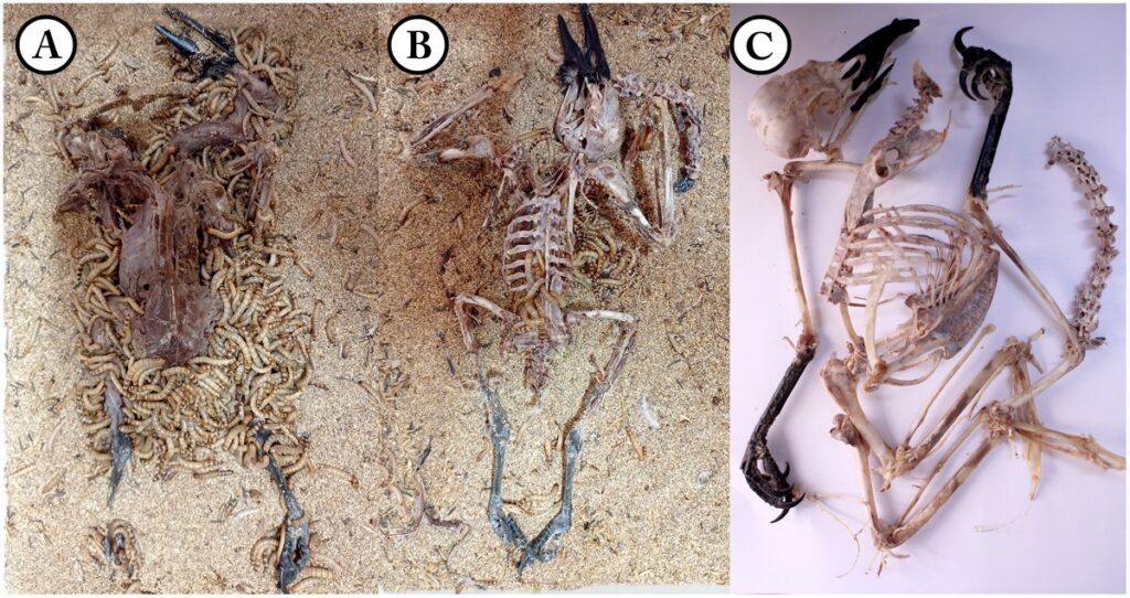

    To find out, Rastekar et al. collected several donated specimens of various sizes and species and cleaned them using commercially available superworms: an Egyptian rosette, a house mouse, a little bittern, an alligator gar, a Eurasian eagle-owl, a rook, a wild cat, and a gray wolf. They also performed a parallel experiment for comparison, cleaning the skeleton of a marbled polecat using a conventional boiling method to remove the flesh.
    Sequential cleaning of a Hooded Crow (Corvus cornix) specimen by superworms
    Sequential cleaning of a hooded crow (Corvus cornix) specimen by superworms.
    All the specimens were skinned first, and the team removed any excess flesh and internal organs. Each specimen was weighed and put in the same-sized containers filled with superworm larvae to determine the optimal ratio of larvae to specimen for thorough cleaning without damaging bones. The team rotated larger specimens every six to eight hours into fresh containers. After each cleaning session, the larvae were fed fruit or vegetable peels, since feeding only on flesh can prevent the superworms from molting or even hasten their death. Any waste materials were removed regularly to maintain hygienic conditions.
    Once the larvae were done chowing down, the skeletons were removed from the containers and rinsed with warm water to remove any residual larvae or tissue. While they did briefly immerse the skeletons in a 1 percent bleach solution, the authors cautioned that this can damage bone tissue, so it’s not recommended. Finally, the skeletons were coated with a clear gloss varnish spray to prepare them for display. (This step would be skipped in a forensic setting, since varnish sprays are not ideal for things like CT analysis.)
    The result: A ratio of 10 to 15 grams of larvae per gram of animal specimen proved the most optimal, minimizing cleaning time while not damaging any bones. Once the optimal ratio had been established, Rastekar et al. conducted follow-up tests on three small bird skulls, with similar results. The authors recommend using larger containers for medium to large specimens to reduce cleaning time and the need to reposition them frequently. “Altogether, these findings demonstrate that superworms provide an adaptable and effective alternative for skeletal preparation in museum and research settings,” they concluded.
