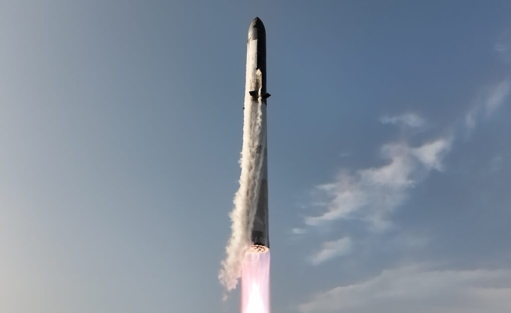

    The ninth flight of Starship began with a booming departure from SpaceX's Starbase launch site at 6:35 pm CDT (7:35 pm EDT; 23:35 UTC) on Tuesday.
    After a brief hold to resolve last-minute technical glitches, SpaceX resumed the countdown clock to tick away the final seconds before liftoff. A gush of water poured over the deck of the launch pad just before 33 methane-fueled Raptor engines ignited on the rocket's massive Super Heavy first-stage booster. Once all 33 engines lit, the enormous stainless steel rocket—towering more than 400 feet (123 meters)—began to climb away from Starbase.
    SpaceX's Starship rocket, flying with a reused first-stage booster for the first time, climbs away from Starbase, Texas.
    Credit: SpaceX
    Heading east, the Super Heavy booster produced more than twice the power of NASA's Saturn V rocket, an icon of the Apollo Moon program, as it soared over the Gulf of Mexico. After two-and-a-half minutes, the Raptor engines switched off and the Super Heavy booster separated from Starship's upper stage.
    Six Raptor engines fired on the ship to continue pushing it into space. As the booster started maneuvering for an attempt to target an intact splashdown in the sea, the ship burned its engines for more than six minutes, reaching a top speed of 16,462 mph (26,493 kilometers per hour), right in line with preflight predictions.
