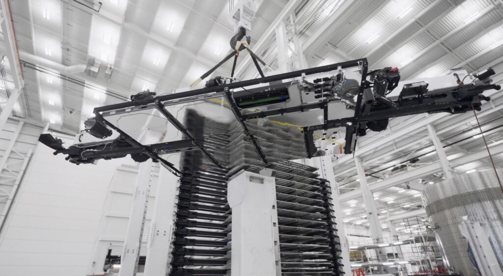

    But there are a few key differences for this launch, set to occur during a launch window that opens at 5:45 pm CDT (22:45 UTC) on Thursday. The most notable change is the inclusion of real, functioning Starlink satellites inside Starship’s cargo bay. SpaceX previously tested the ship’s payload deployment mechanism using simulators mimicking the mass and dimensions of the company’s next-generation Starlink Version 3 broadband satellites.
    This time—Starship’s 13th full-scale test flight and the second to use SpaceX’s newest version of Starship—technicians have installed 20 Starlink V3 satellites into the ship’s deployer, a system of pulleys and cables designed to eject a stack of satellites one at a time through an opening on the side of the spacecraft. The satellites will not be part of SpaceX’s operational network, but engineers will attempt to briefly establish laser communication links between the Starlink V3s and other spacecraft flying in low-Earth orbit. If successful, these links will validate Starlink V3’s interoperability with SpaceX’s previous generation of Starlink satellites.

    A Starlink satellite simulator is prepared for loading into SpaceX’s Starship rocket before the 12th test flight in
    May. The next flight will include functioning Starlink V3 satellites.

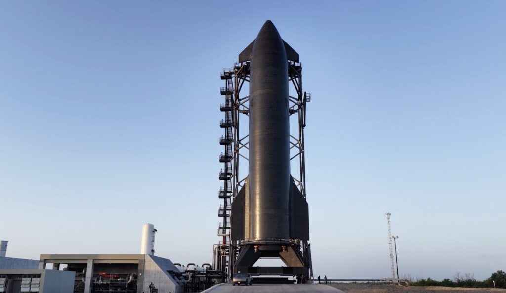

    Ship 40, the Starship vehicle slated to fly this week, undergoes testing at Starbase, Texas. Thousands of black
    ceramic heat shield tiles are visible in this image.
    SpaceX will also use Flight 13 to continue experimenting with Starship’s heat shield, one of the most daunting technical challenges on the program. If the full rocket is to become rapidly reusable, as SpaceX intends, the heat shield’s thousands of ceramic tiles must not only protect the ship once. They have to be robust enough to handle the extreme heating of reentry over and over again without refurbishment or replacement.
    “What’s single biggest remaining problem for Starship? It’s having the heat shield be reusable,” Musk said in February on the Dwarkesh Podcast. “No one has ever made a reusable orbital heat shield. The heat shield’s got to make it through the ascent phase without shucking a bunch of tiles, and then it’s got to come back in and also not lose a bunch of tiles or overheat the main airframe.”
    “We have brought the ship back and had it do a soft landing in the ocean. We’ve done it a few times, but it lost a lot of tiles, and it … would not have been reusable without a lot of work,” Musk said. “If you want to be able to land it, refill propellant and fly again, you can’t do this laborious inspection of 40,000 tiles type of thing.”
    On this flight, SpaceX will test out modified tiles and attachment mechanisms to gather flight data on different heat shield options. The shield will also have “load sensing tiles” to take measurements as the vehicle experiences higher dynamic pressure during ascent than on previous flights. This higher dynamic pressure will put “added stress on the tile attachments in exchange for increased payload to orbit capability,” SpaceX said.
