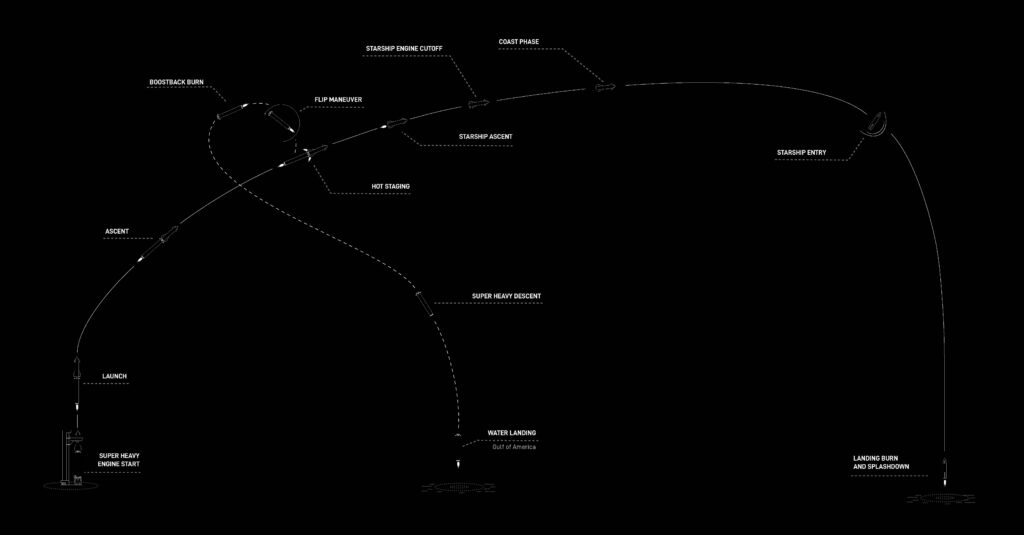

    SPACEX_STARSHIP_INFOGRAPHIC_032425_DESKT
    This graphic provided by SpaceX illustrates the flight paths of the Super Heavy booster and Starship upper stage on Flight 11.

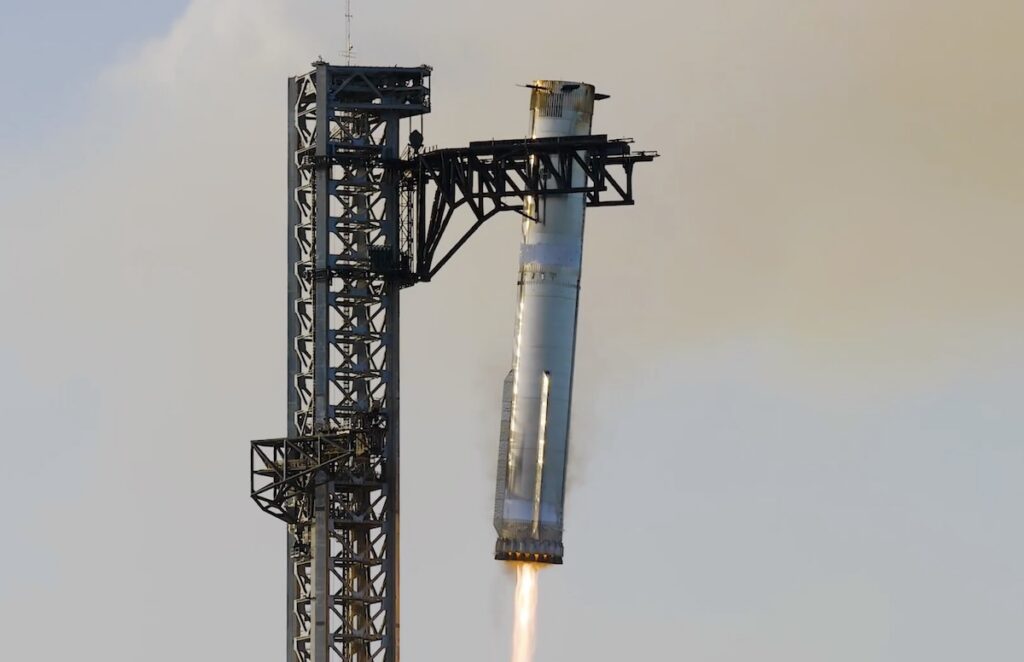

    While SpaceX is still some time away from recovering and reusing Starship's upper stage, the company is preparing to take another step forward in reusing the rocket's massive Super Heavy booster. The next flight—Flight 11—will mark the second time SpaceX has reused a Super Heavy booster flown on a previous mission.
    This particular booster, numbered Booster 15, launched in March and was caught by the launch tower at Starbase after returning from the edge of space. SpaceX said 24 of the 33 methane-fueled Raptor engines launching on the booster next month are "flight-proven."
    The Super Heavy booster flying next month previously launched and was recovered on Flight 8 in March.
    Credit: SpaceX
