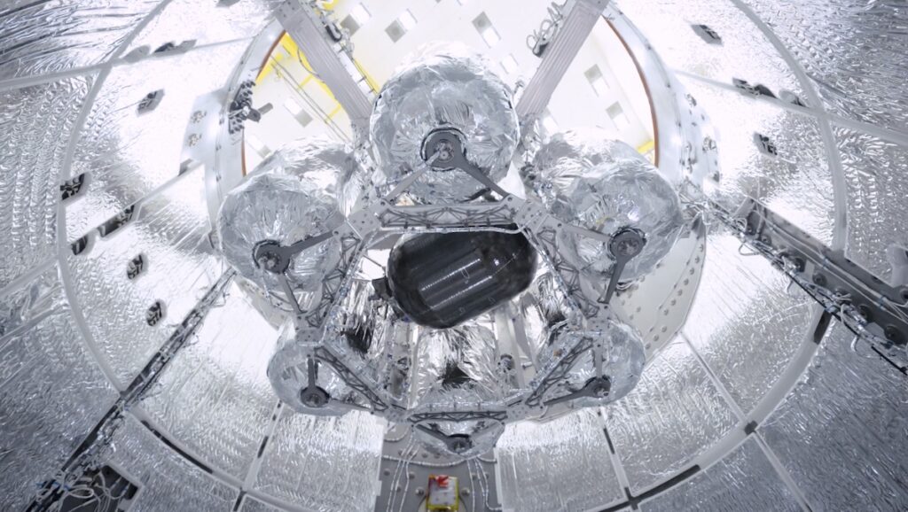

When NASA asked SpaceX to modify Dragon for larger reboosts, engineers devised a new propulsion pack to be placed inside the hollow trunk of the spacecraft. This unpressurized compartment is mounted below the craft's pressurized cargo cabin, and it's where SpaceX usually carries larger experiments that are robotically attached to the outside of the ISS.
For this mission, SpaceX installed two additional Draco thrusters into the spacecraft's trunk. The small rear-facing rocket engines are closely aligned with the station's velocity vector, and they're connected to six dedicated propellant tanks in the trunk containing hydrazine and nitrogen tetroxide, combustible fluids that ignite upon contact with one another.
"Our capsule's engines are not pointed in the right direction for optimum boost," said Sarah Walker, SpaceX's director of Dragon mission management. "So, this trunk module has engines pointed in the right direction to maximize efficiency of propellant usage."
When NASA says it's the right time, SpaceX controllers will command the Draco thrusters to ignite and gently accelerate the massive 450-ton complex. All told, the reboost kit can add about 20 mph, or 9 meters per second, to the space station's already-dizzying speed, according to Walker.
