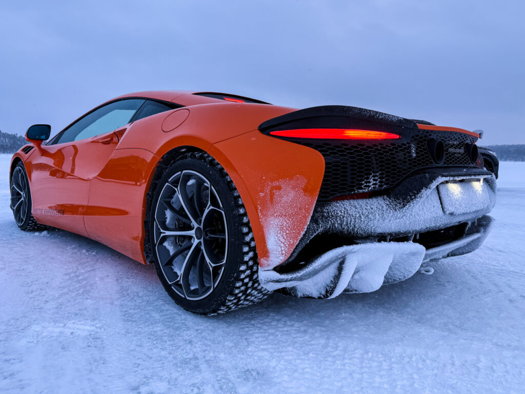

    An orange McLaren Artura, seen from behind on a frozen lake. The rear is encrusted with snow.
    The Artura is probably my favorite McLaren, as it’s smaller and more versatile than the more expensive, more powerful machines in the range.

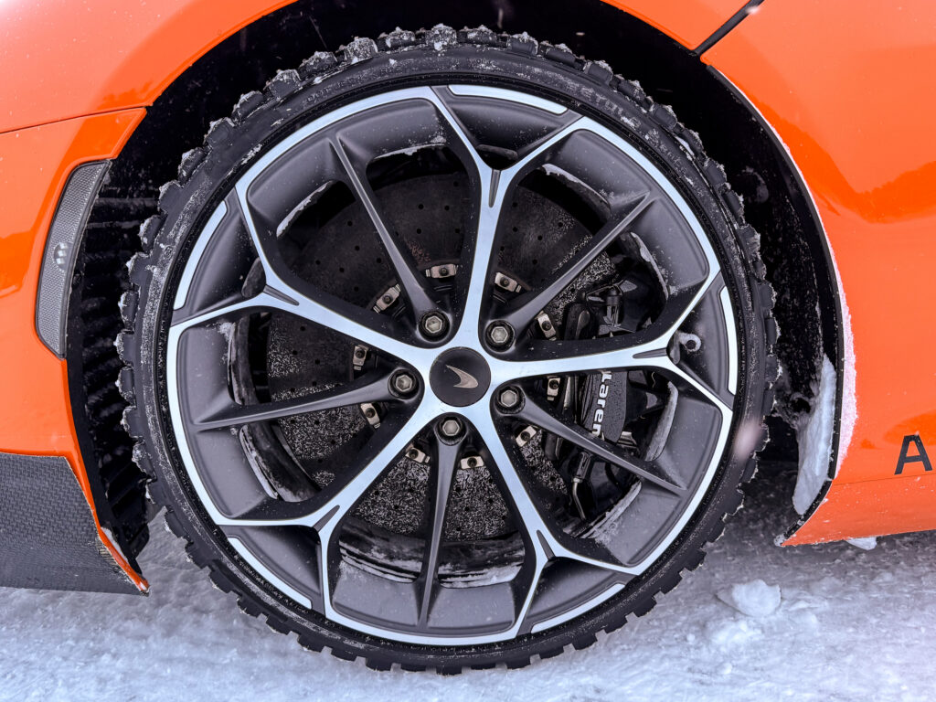

    A McLaren Artura winter tire fitted with studs
    Winter tires work well on snow, but for ice, you really need studs.

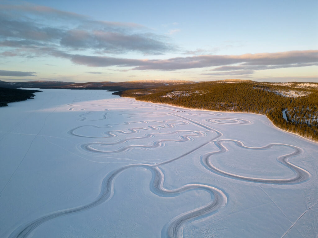

    A number of circuits carved into the surface of a frozen lake
    These are just some of the circuits that McLaren has carved into the ice in Ivalo. Beware of the innocent-looking circles—they’re deceptively hard and may turn your stomach.
